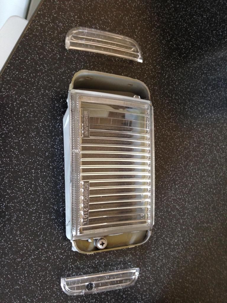

Now I've only completed one fog light so far, I am currently working on an indicator lens which I have split.

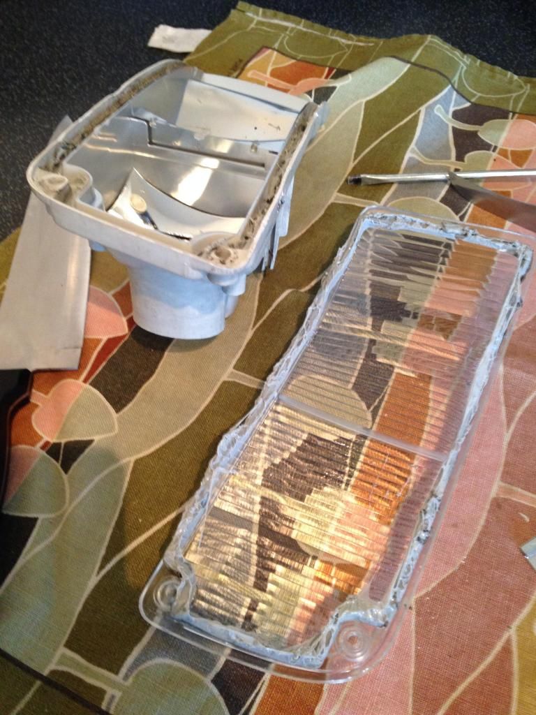

Firstly, I removed the lens, heated the lens in the oven to soften the plastic and managed to work the corner tabs out without breaking them. Now my fog lights are not very old, so older ones might be more difficult.

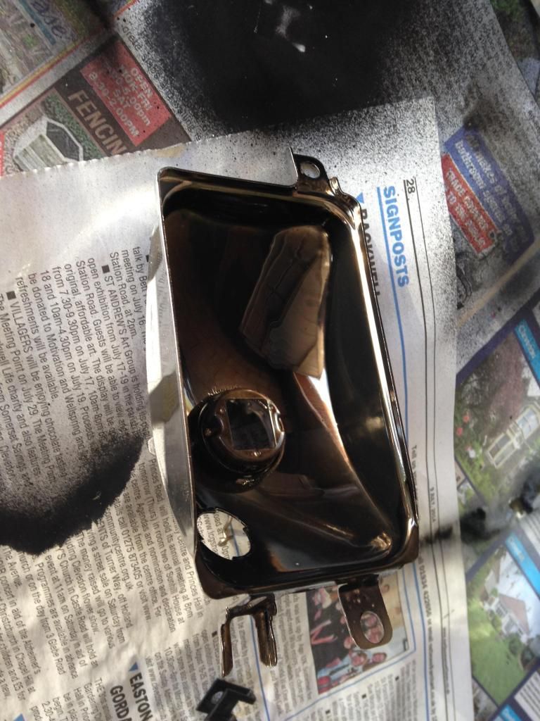

Once that was done, I masked up ALL the glass, including the level adjuster screw (wanting to keep it OEM-esque you see) and blacked out all the visible plastic, which included the sections under the corner tabs.
I just used a normal satin paint for this. When I 'masked' the inside of the inside of glass, I pushed newspaper up under it as the glass curves round where you can't mask.

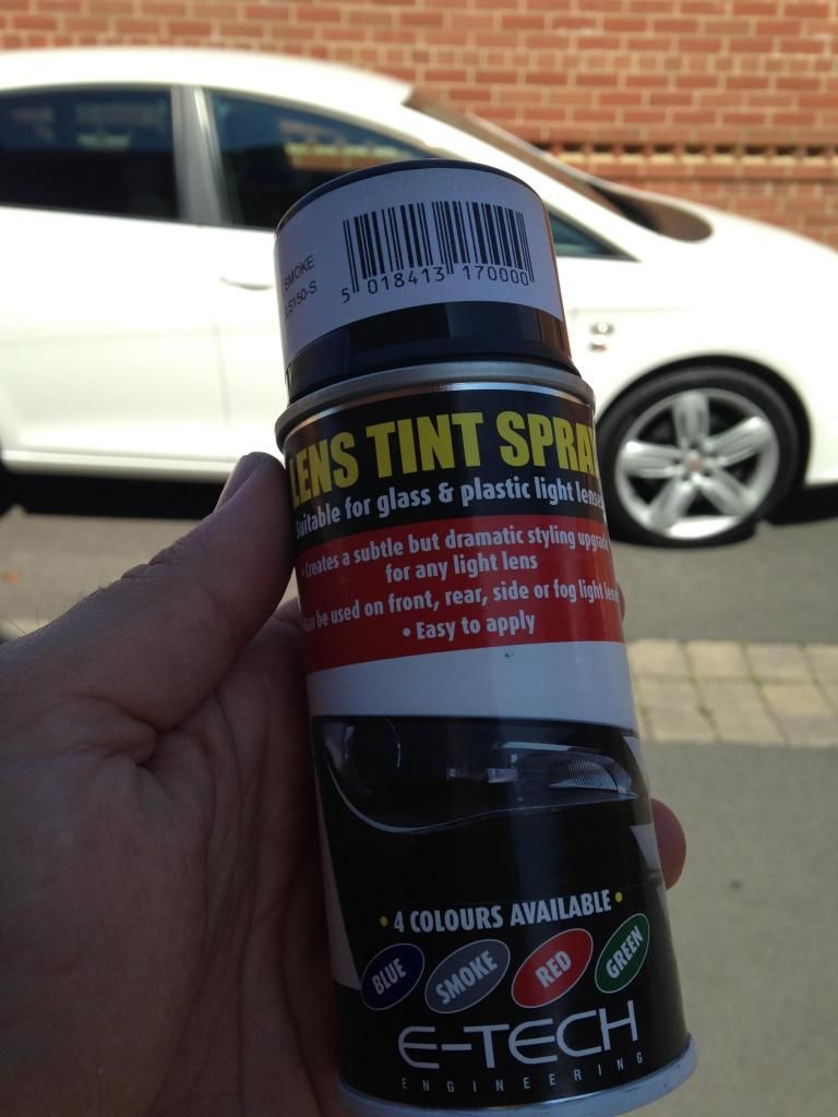

Next thing to do was do 'tone down' the visible glare of the fog light reflectors. I still wanted these to reflect, so I managed to get hold of some of this horrible stuff, that tacky light tinting spray that kids used to use to black their rear lights out. Actually this stuff is very good, all it really is is a tinted lacquer and it goes on very glossy.
I did about 3-4 light passes on both reflectors and made sure I covered the very corners as these would be the most visible through the lens. The reflector now took on a really glossy shadow-chrome, so it still has a good deal of reflective properties, something that I would have lost simply by painting it gloss black, which would have looked rubbish as I still wanted the reflector to be visible through the fog light so as to appear 'OEM type'.

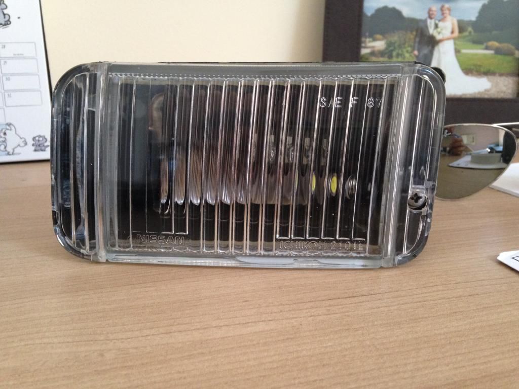

Now fully assembled awaiting to be fitted onto the car, I am very happy with the results. NONE of the glass has been touched, it's all an effect of the colour of the backings.

Yeah, looks clean that Si. I do wonder how affective the fog lights will be after that treatment though.
This is why I used a tinter rather than blacking them out; they're still highly reflective. I never use the fog lights anyway, but I can't imagine there'll be too much difference as the reflector only has a light coating. The photo of the lens was taken in a dark garage and it's still reflective and you can still see the reflector clearly through the fog light lens once all fitted back up.
