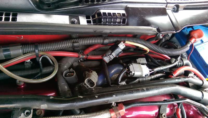

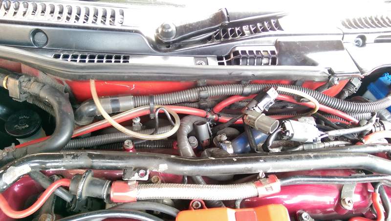

However, I'm struggling to locate both VTC solenoid connections - I've only found one 2prong grey plug at the back of the plenum and unplugging that does nothing - where it the other one??
I also have a couple of unplugged connectors and I'm not sure what they are for - they certainly haven't been unplugged by me and I've not had any engine work done in a long time so don't think they're the cause.

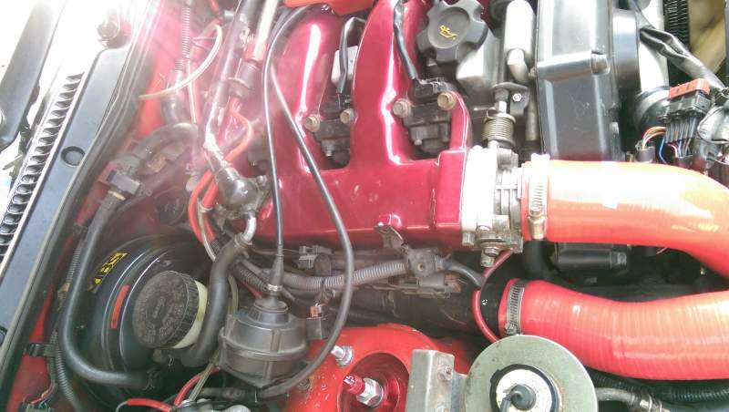

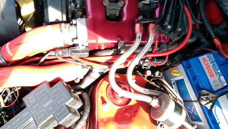

And a few pics of what I can see in the engine bay in terms of connectors:

Can't be the O2 sensors disconnected as I changed the passenger side last weekend and ran Conzult after to check and both were showing up. Haven't touched the engine after that. Plus the two connectors I see are both female and one has been taped off. I can't find the male connector back there at all...??
The one taped off will likely be the knock sensor resistor mod.
