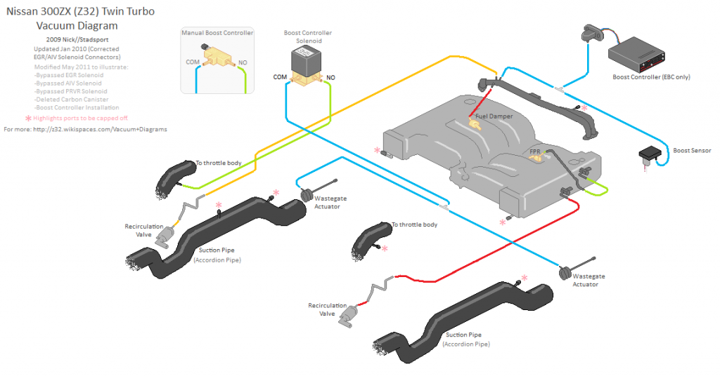

Up in the top left hand corner of the engine bay, there is a little black rectangular box with a single vac hose coming from the bottom of it, I think this is the one Noz mentioned where I attach the MBC to?
There is also another little box further down underneath in the same area with two vac hoses coming out the side and also a hose underneath from it, just again want to make sure I am connecting it to the correct thing.
Also where exactly do I connect a boost gauge to?
Cheers.
Thanks mate, that shows the boost sensor that I require perfectly.

The end of the MBC that is inline with the bolt is connected to the two hoses that are t pieced together from the wastegates, and the end that is at a 90 degree angle is t pieced into the boost sensor?

The way you have it set up will give unlimited boost (and a very small vac leak through the MBC bleed hole!). If you look at the instructions that came with it, you'll see that the pressure source goes to the connector OPPOSITE the adjuster.
Also, it would be better to have the MBC outlet tee'd into the actuator lines at an equal distance from both actuators. The way you have, it is closer to the driver's side than the passenger side.
