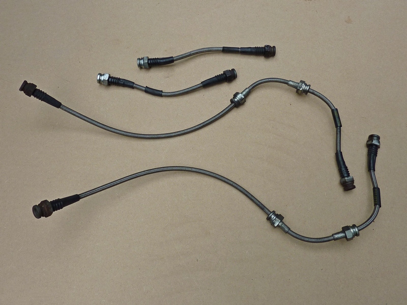

What lenght are the brake lines doing a evo 8 brake swap myself and iam getting brakelines made up
just wondering what size in lenght il need
The Technafit lines I sold recently measured 59.5cm for the fronts and 21cm for the rears (total lengths
including the fittings).
