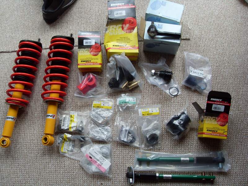

as some have seen I did a full refurb on the rear sub few months back its time to start front sub will be removed all parts stripped powder coated new kig pin bearings ball joints track rods drop links polly bushes new koni suspention and new tein tension rods new stone chip in arches and under seal here is the first pics off all the parts in volved and were am upto so far in the job all stripped out I will post more pics as I go to help anyone in the future do this job SDC12441.jpg

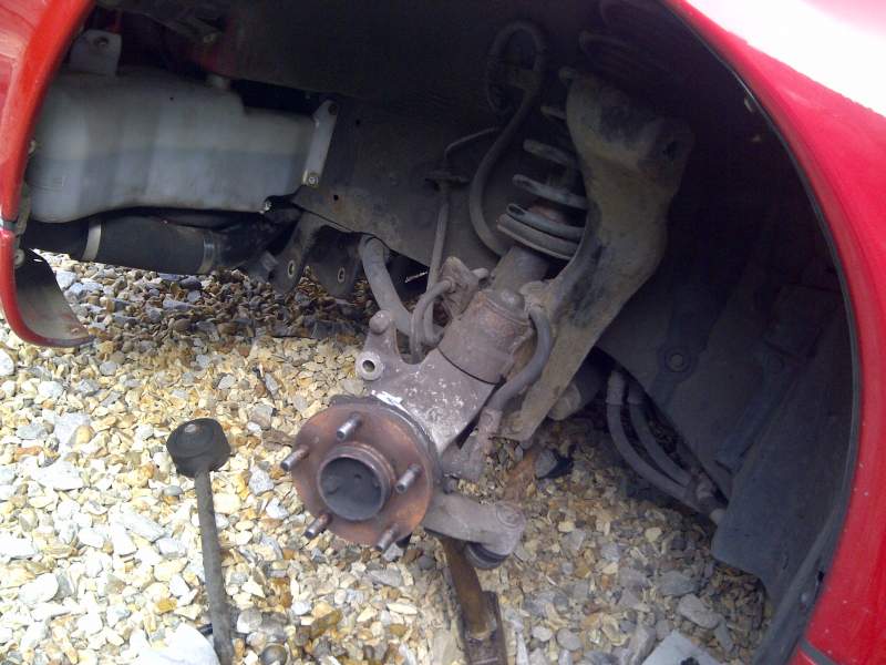

been a while but the job is back on now removed front sub frame and all other parts here is the pile ready for powder coat will update as I build it back up SDC12464.jpg

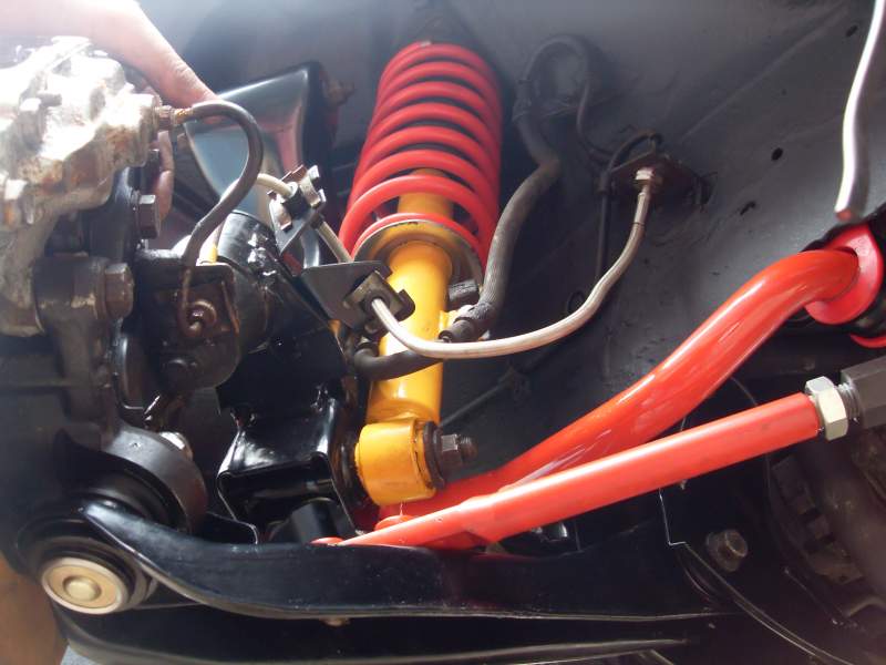

when I did the rear frame the place I ment to had a sand / shot blaster them powder coat here is the rear sub I done few month ago

ok update got all the part back from powder coat have undersealed the whole car and stone chipped the wheel wells time to build it back the sway bar it bright red looks orange in the pick

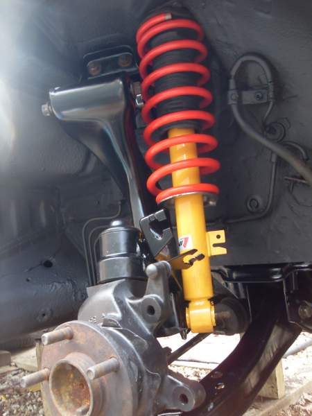

sub frame and rack is back in the car wil update with more pics as I go with the rebuild
before clean out pics and after new stone chip pic
rack back in sub with new polly bushes

hubs cleaned a now painted backing plate chopped off to make room for the new brakes when I get some in the summer
