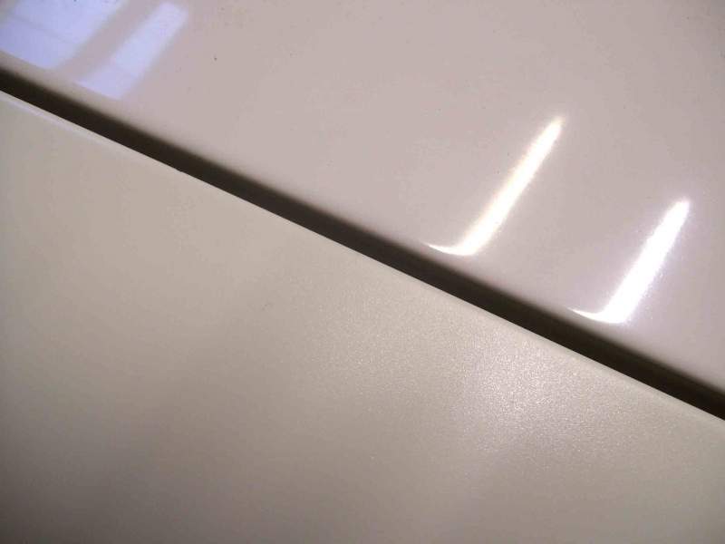

I have been using Arctic white 326 from Halfords but it doesn't match, seems a bit creamy. Not bright white at all!

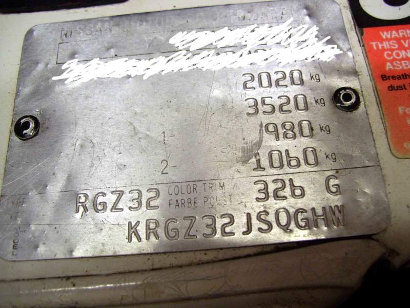

Can someone help me identify the correct paint code please?
My year is 1992 (uk model)
Below is a picture of my VIN plate.
Is the "G" significant?

I would suggest that either your car has had a cheap ass blow over in the past, or the Halfords paint is crap.
Try getting some paint from paints4u. They're the best paint match I've found in aerosol form.

The paint code is the important bit.

So are you saying that if Halfords were to mix me 326 it would match, even though the same graded aerosol can is way off?
I am reading that the coding itself is a bit missleading as it can cover several shades.
Does my link sugesting mine is could be Super White not bear this out?

No mate - I'm not saying they'll get it right; just that the paint code is more important than whatever the actual colour is called!!
I was probably lucky in Halfords - and if you remember that the car might be up to 25 years old, weathering and other environmental conditions might have had an effect on the original paintwork in that time. So even the right colour match from the factory could be a shade or two different if applied to the car now. Which is why a good body-shop will have a colour analysing device, enabling them to mix paint to the right shade and appearance as the other panels on the car.

I get what you are saying Richard, it's just that the original paint in contrast to the newly applied paint is far brighter.
Almost a pure white.
Not as if it has faded, which I could understand. My picture dose not really show the difference in shade.
I am not convinced as yet that my 326 code does not refer to Super White as the link, although it appears to be a US specification.

The wing almost looks like it's pearl white!
I would have thought that paint found in the door jams and on the body under the rear hatch is most likely
to be representative of the orginal Nissan 326 colour. It should have had the least exposure to the elements.
I know that when I had the rear bumper and spoiler painted the sprayer explained that although the colour
was TK3, he had correction codes to allow for age and weathering.
In addition to what Andrew says, white is really prone to bleaching and can be really noticeable. Paint matching and panel blending will be a necessity. The paint in your Halfords aerosol will be a mix of the original pigment weights, not what your paint is currently now after weathering and general discolouration.
