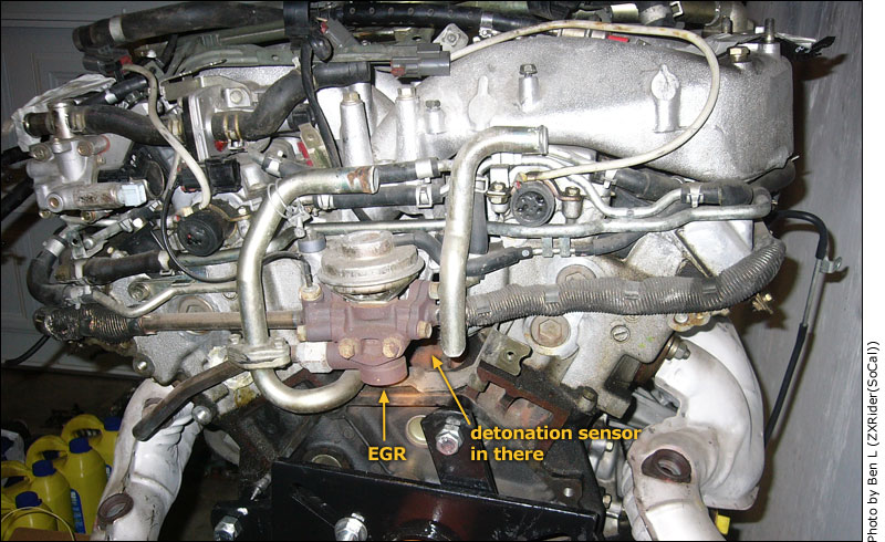

So for a start, did another boost leak test yesterday, It still seams to be coming from the back at the top. got underneath it and the turbo's sound fine.
It appeared to be coming from this thing (red circle)
there was some oil around the bolt that was rippling in the breeze (from the boost leak I'm assuming) but no amount of soapy water was making any bubbles, although it was slightly muffling the sound when the rush was around it.
Tried tightening both sides which seemed to help a bit, but still didn't stop the leak.
Also I was wondering what the thing is the green arrow is pointing too?

just to help with the photo, they appear to be pipe exits, one either side of the engine (left and right) they look like they go through the bulkhead, but I could be mistaken it is very tight.
The photo is taken from the passenger side with me leaning over the battery.
I bet the air is leaking from the EGR valve (small vac pipes going to it) at rear of lower plenum.As for the water leak it does sound like one of the 2 matrix pipes but looking at that pic ide be pulling the plenum off and redoing all rubber pipes (water and air).Good excuse for a full water pipe delete while its off too:cool3:
Jeff deleted the EGR before Christmas, I can only assume all the pipes would of been blocked off too.
I've had another look and yeah I was wrong saying the red circle is a pipe, I can see now its a sender of some sort, it's got a cable coming off it.
[ATTACH=CONFIG]79416[/ATTACH]

what you have circled in red is the VTC solenoid for the variable valve timing.

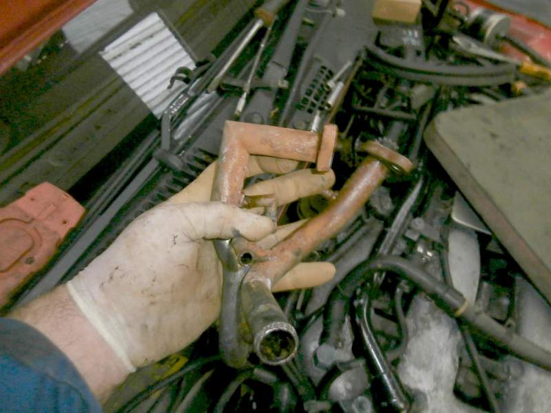

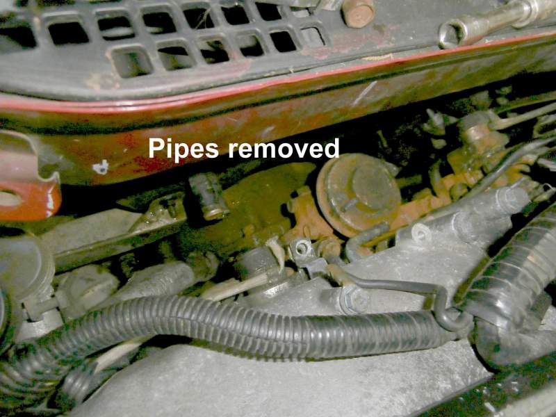

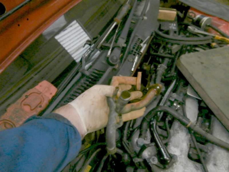

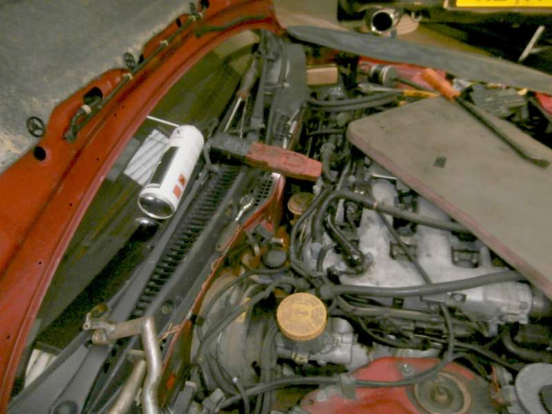

Here is how, from last year:
Anyone who has worked or tried to work down the back of the zed engine knows that the space between the bulkead and the engine is at a premium. Unfortunately there are a lot water pipes down there and when they need attention it cam be a royal pain but even the metal water pipes from the engine to the heater matrix can loose the corrosion battle.
The pictures give a little indication what is involved to remove the steel pipes, with the exception of the missing skin of the back of my hand but hey that goes with the territory!
Could not take a picture when my hands were down there but believe me it was tight to get the drivers side pipe fixings as they turn back into the engine, and of course getting them back in.... that`s another story!
If you fancy having a go at this job move as much of the loom that you can and the battery cable to the starter motor, locking the bonnet right back is essential too, I use a foam lie down slab and end up liying down on the engine its works for me anyhow.

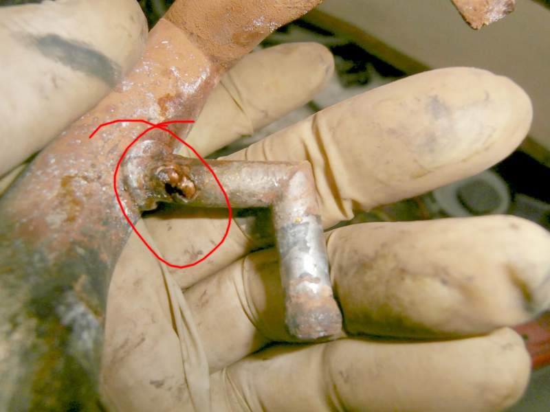

Well tried two avenues, my mate got me a new pipe, and I got some belzona chemical metal, so bit the bullet and took the old pipe off. decided to strengthen the new one with some of the emetal, just waiting for it to cure before we fit it.
there's the little pin hole that caused all the problems.
And here's the new pipe
