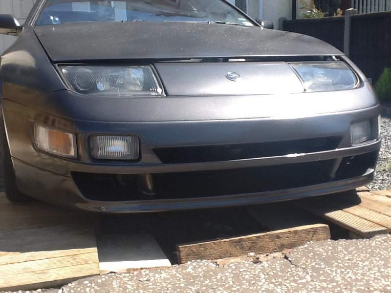

It's graphite grey with pearl met kh2 when it's cut back and the lacquer on then it stands out

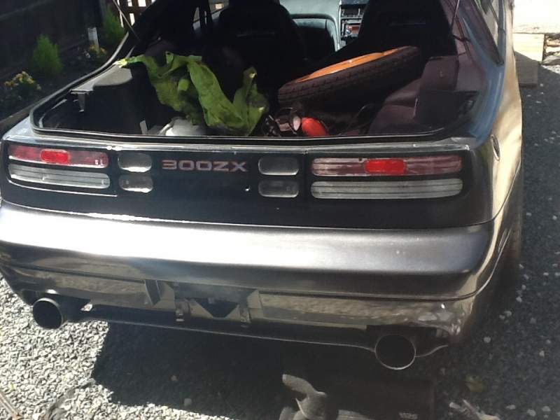

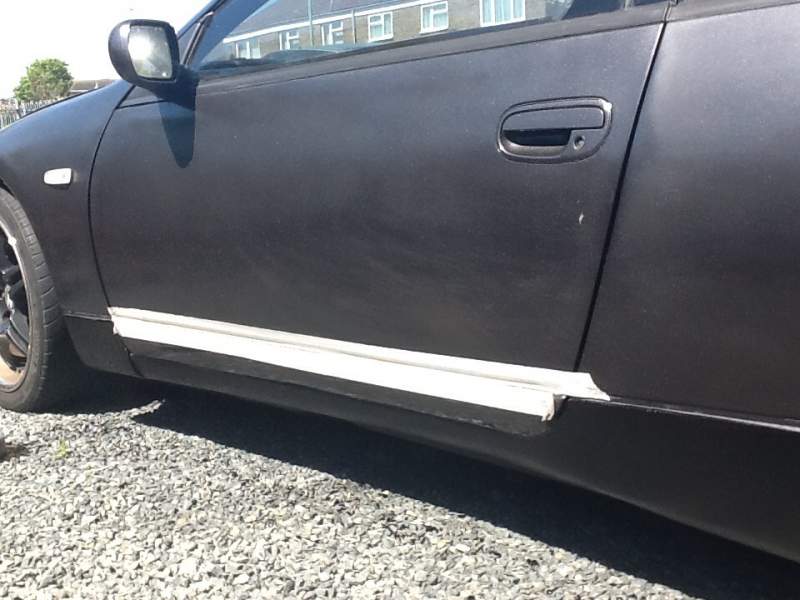

Right that's it for a wk haven't put the side skirts on yet then cut it back to lacquer itimage.jpg
Did I read that correctly....? You haven't lacquered it yet? :confused: You can't cut-back metallic base coat....
Why si I thought you could
Hell no! NEVER ever do that. You need to lacquer straight on to metallic base coat. You'll totally screw up the 'lay' of the metallic particles, you'll get dark spots and all sorts. Not something I would do. It's the lacquer you cut back. I'd degrease that and then lacquer straight on top, however, I would have allowed the paint to partically dry and then hit it with 2-3 layers of lacquer rather than left it. Good job I told you!
Edited by Funkysi
Ho pants ok not going too leave it a wk I'll go get the lacquer out of the shed
Lots of fine layers remember. Doesn't matter if it doesn't give an ultimate gloss straight out of the gun, as long as coverage is even with no runs or dry spots, you can cut back with wet and dry after before final polishing.
