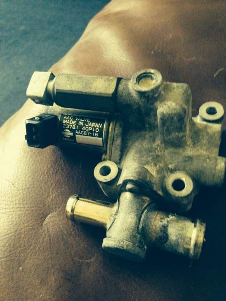

not an expert but sounds a bit similar to what was happening to mine the actual idle control valve itself was changed to resolve it but like you point out there's lots going on , pipes , electrics etc :)
Interesting, first i have heard of that one, where is it and is it expensive
rich
just dug out the old part from my kitchen drawer :) its called an AAC Valve

cost me £65 for the part at jefftt

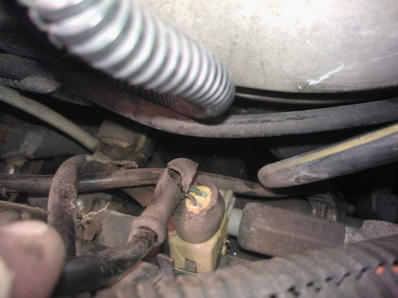

Right plan was to swap out the AAC valve situated just right of the battery (sitting in car as always) cant really miss it, it has a yellow connector on it, so firstly i had to remove the one from my "spare" car, i cant impress upon everyone to get one, its a lifesaver. Anyway. started to remove the AAC, one thing having a spare car does is that apart from give you the part, it allows you a "dry run" on the procedure, what to clear away, what not to break!!. After a little while i had the AAC valve in hand. so off to the proper car...
Everything went well, but i was hesitant about moving the wiring loom up/down left/right as the keen eyed amongst you will remember my issues with moving the loom caused misfires. However i proceeded with this action as you have to move the main loom around to gain access/visibility. i got to the point of just about to remove the last of the 4 bolts holding it down when something caught my eye and i saw this

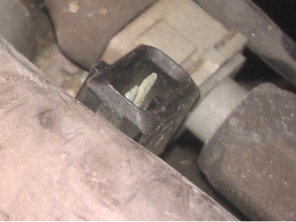

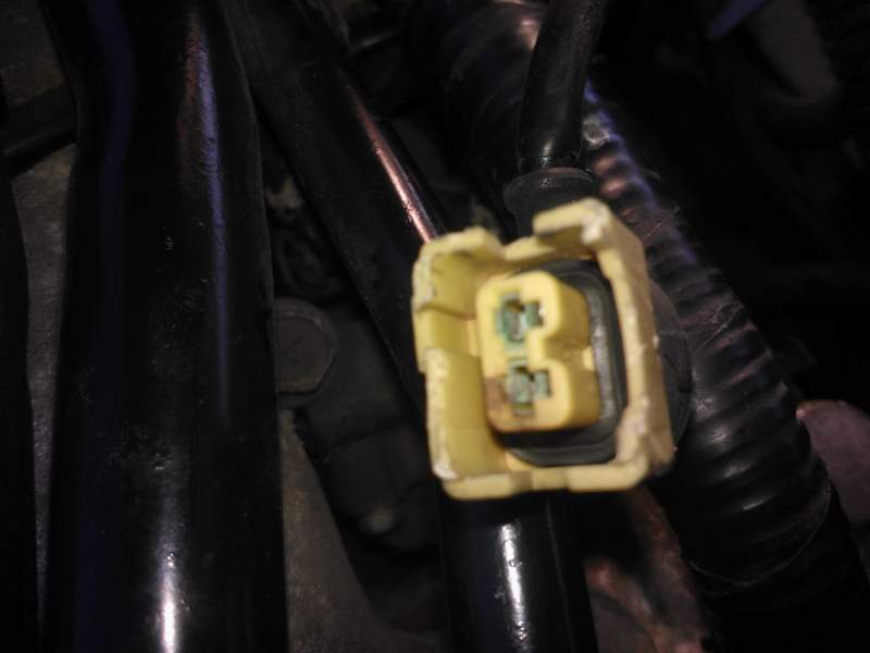

Well thats not right i thought, and through my many post i have read recently on hesitation etc, this yellow connector came in for a lot of discussion. so before i remove the AAC valve, i thought id take a closer look. so i quickly popped the bolts back in and pinched them up. I will say here that getting access to this connector was bleeding difficult and did consider kidnapping a small child with small hands to work on it. I eventually removed the connector only to be confronted with our worst enemy (drum roll) yep you guessed it ..GREEN CORROSION!!!
Both in the connector and the socket.
So i decided to fix the connector first and order up a gasket (which had disintegrated from my spare car) and swap the valve if the conn fix didn't work. The yellow conn was fubar, so i cut off the end and soldered the spare one on which was unusually pristine, with the socket i very carefully attached some glasspaper to a fine long screwdriver and slowly cleaned it up. Then filled with vaseline and attached it to the valve. Now came the hardest bit of the job, there's always one in every job. Fitting that u clip, wouldn't have been so bad if it came from the batt side but it was from the other side where finger access was tight, now what did i do with that child... Easiest way was to pop it just on the connector, carefully place it down on the socket and then push it on. So all done, everything back together and then time to start it up. Before when i started, it would rev up as normal then die. This time it fired up (instantly) and held revs at 1400, great! While i tidied up i left it running, as it warmed up it gradually reduced the revs, however when it was at operating temp the revs were a bit high. Maybe something for another post. Took it for a drive and when selecting gear it didn't die either.
Thinking back, my misfiring which i thought was caused by moving the loom wasn't caused by some iffy connections in the loom but obviously by moving the yellow connector which with the corrosion was sparking out.
