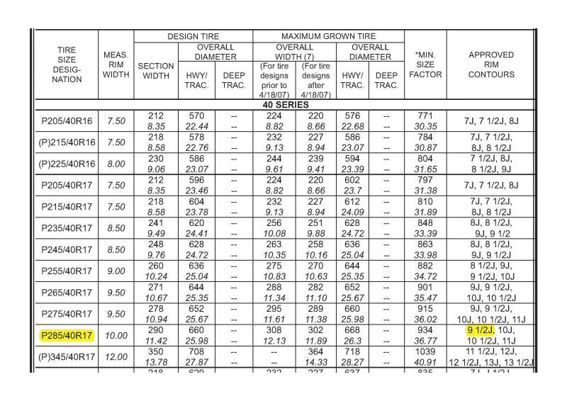

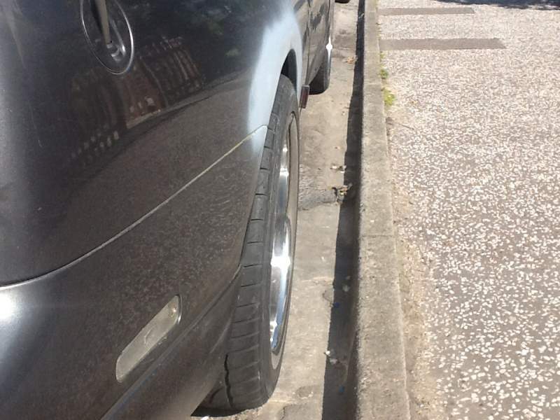

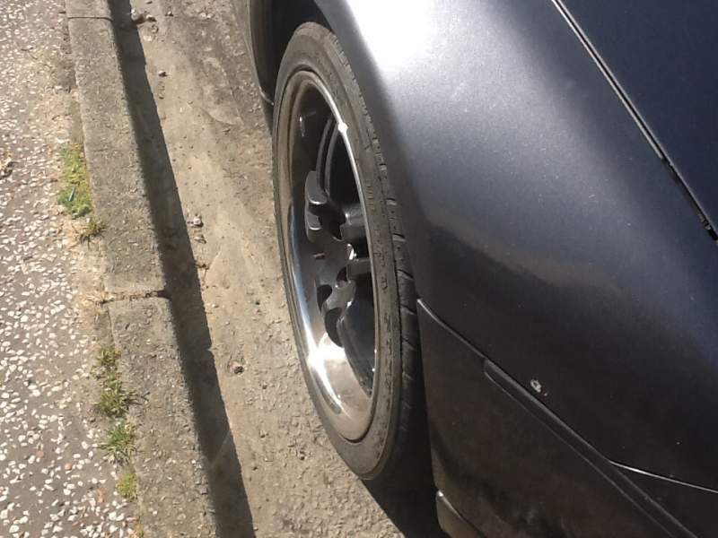

So the question is what’s the widest rear tyre you can fit on a Z32 with standard body work? Rolled arches are permitted. Who’s got them and what does it do for the traction?
I know I can fit 285s on my 9½JJ wheels, but will they then fit in the rear arches?
