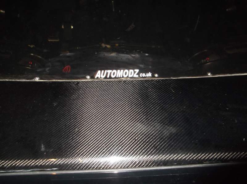

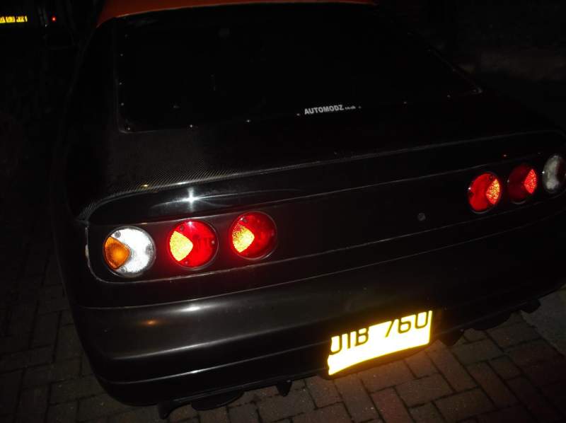

My car has been sticker-bombed!!!!
looks like you'll have to sell that carbon boot to get rid...oooh, i'll buy it! :tongue_smilie:
No idea but he should peel it off before his paint work is damaged !
Its on the rear polycarb window...so it can stay.
There is good reason for it being there in reality.
More info to follow......................................:yes:

the reason Mark put one of his Automodz stickers on the car was he had done work on the car for me.
Basically I asked Mark to put my new NA engine in the car. i simply cant do jobs like that on my own at home now.
I went to help him and the swap went smoothly enough.
However getting the car to run proved almost impossible due to a whole bag of gremlins and dodgy components.None of which were Marks fault
Wrong injectors (my fault), terribly made Z1 throttle bodies, the usual mystery electrics faults etc etc. Plus overfuelling killing a set of plugs
Mark and his lad worked their way through all of it and I ended up bringing the car home running on its original Central 20 Racing and a MAF!!!
Finally my mate Steve was able to come to my place today and get it back running reasonably well on the Emerald ECU. Mark came over to assist.
It is booked in to Emerald for a full remap later this month but in the meantime it looks good enough to make Japfest and probably go on track using modest revs .
So tonite I have been for a drive with the Emerald on Closed loop self learning mode. A few sessions this week should get it 90% right
First impressions are that the engine has been nicely built and it is quicker.
Im very happy and relieved.
A big thanks to Mark for all his hard work and efforts with this job.
