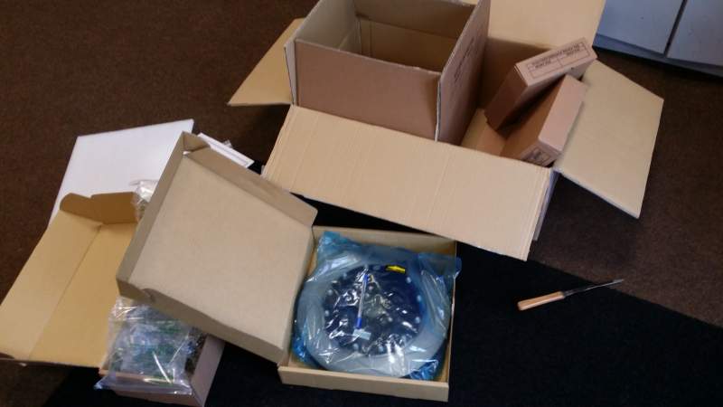

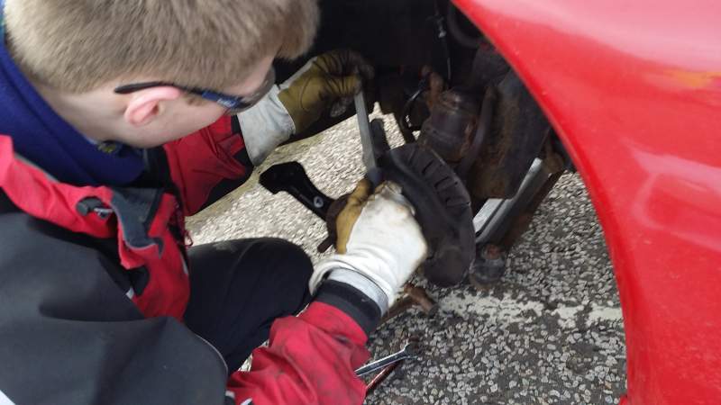

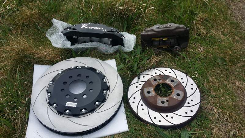

They came beautifully packaged, everything I needed. Fairly straight forward fitment other than needing to tin snip the dust plate and file 3 mm off the hub. Seem really good quality and they are already starting to really bite hard, but I am breaking them in carefully as I should. Automodz got mine at a better price than anywhere I found online.

I ordered 356mm 8 fronts and 330 4 pot rears. With default pads, despite the poor reviews for the standard pads because I bet theyre totally fine. The rears use the standard drums.

I know there are various ones that can be used but don't know the ins and outs of it. They are quite expensive and you only buy the rotor (the silver bit round the edge)

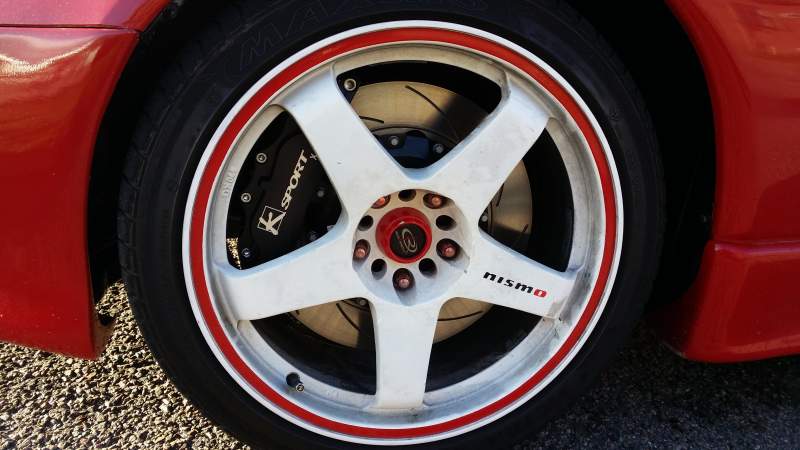

They're probably bedded in now, 150 miles of country roads, they're powerful, brake straight, and the pedal is fairly firm. I now have about 15mm of pedal that's like 2 clicks of handbrake, then it goes very hard over about 3mm and gives me a feeling of unlimited braking, but I haven't leant on them yet, that bit where they start to bite moves your head forward.
I think the slight slack is my not yet adjusted master brace and standard rears. The pedal will be like standing on a brick when I am finished.

They started off pretty good a bit spongey then got better and better, I bedded them in in about 350 miles rather than 500, because I could do 500 miles on the motorway and not use them at all. All my miles were country roads and I was careful, trailed the brakes lightly cruising in 5th, did sympathetic stops from speed with pulsed braking all sorts. Some other brake manufacturers say "put them on and do 10 emergency stops from 60mph, brakes bedded in!" So I mixed it up trying not to overheat them.
Once they were, they were everything you would imagine these to be, firm and a 'little bit' bitey. They bloody work though, I did at least 10 miles at full on "race pace" and the speed you can travel from A-B... braking late and hard and rolling off them towards the apex is awesome. I didn't know what I was missing till I fitted them!
