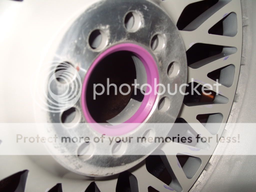

Well i bought my alloy wheels 2nd hand last year and fitted them straight away but not having driven many miles or at speed for some time its only since i started running my car this year i noticed quite a bad vibration from the front end over 60mph. had the car aligned and all the wheels rebalanced to no avail until after some tinternet research turned up some comments about plastic spigot rings.
I must confess all the alloys ivehad in the past on all my cars have ben more or less a direct fit so ive never come across these rings before.
So while on fleabay i came across a set for £4.95 posted so took a punt and bought a set.
So they arrived, a nice purple colour too so fitted them and took the car on a run to shrewsbury and guess what virtually no vibration at all.
So big result as i was that fed up of how crap the quality of the drive was before i was planning to get rid of the wheels and go back to my stock JDM ones and see if the vibration was still evident.
Car now drives super nice well over the limit so lesson learned and i can now have the wheels refurbed in the shadow chrome finish i wanted so happy days
I was dreading driving to the early shows this year but now i cant wait.

Just whip a wheel off and measure the diameter of the centre hole and the diameter of the flange on the hub that should give you a good idea.
I bought 73.1 66.1 ones
I couldn't fit the vernier gauge in there, I didn't think a tape would be accurate enough?
66.1mm is the standard bore of the hub, measure the inside diameter of the alloy to give you the other measurement needed. Most after market alloys likely need spigot rings unless specific to the Z32.

...When I first had my new wheels fitted, the tyre place didn't bother with them (but at least they handed them back); saying that the tapering of the wheelnuts would hold the rims in place OK. WRONG!!
I re-fitted them myself and the transformation was quite unbelievable!!

Had the same problem a few years ago. Tried everything and vibration was still there only noticed when I was changing my tyres. And since I stuck some rings on it's been running perfect ever since.
