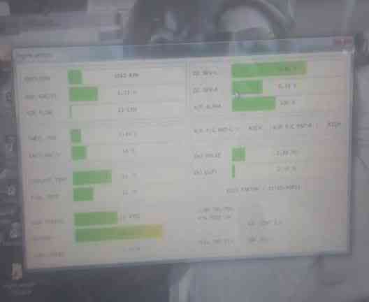

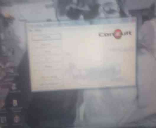

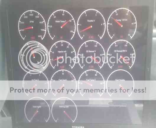

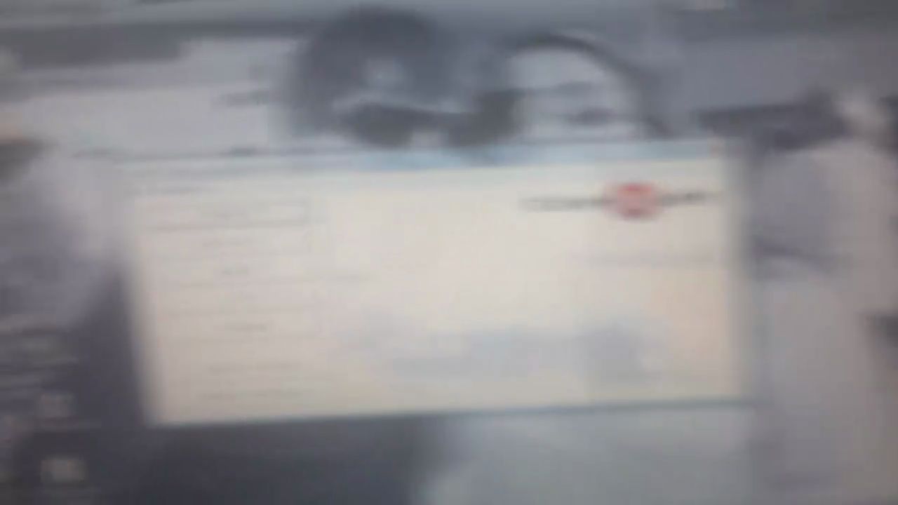

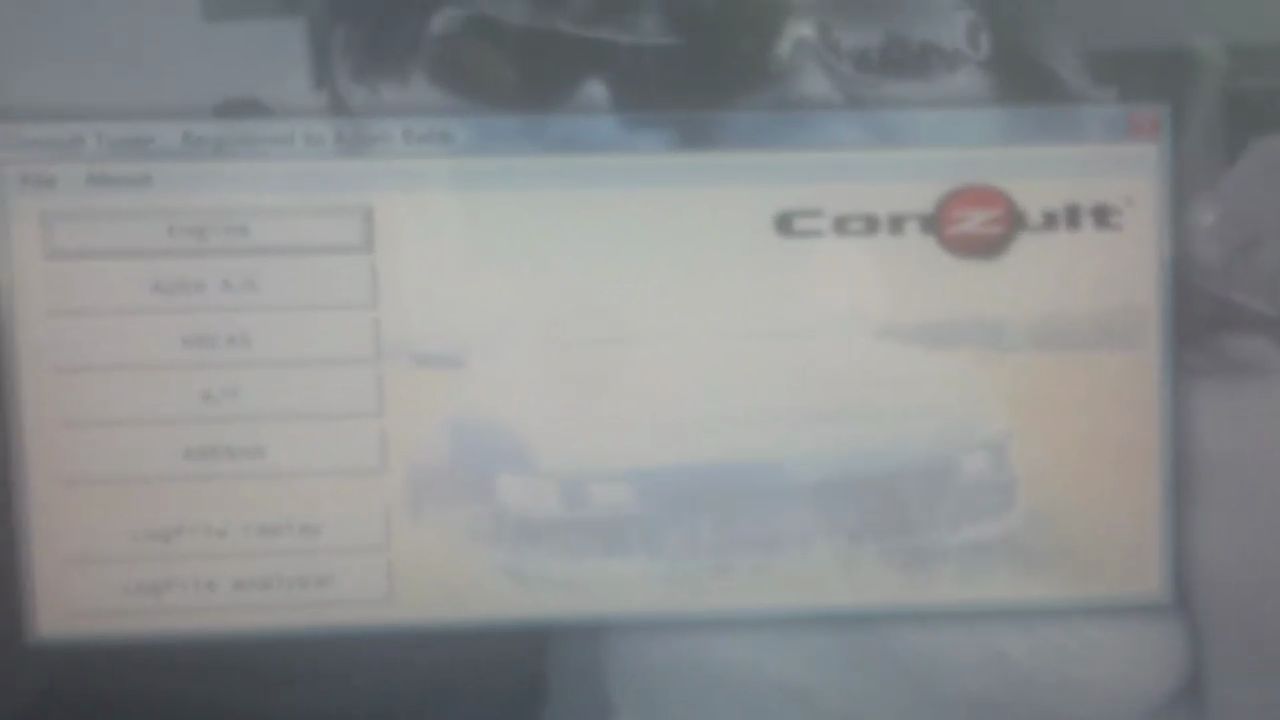

Hey guys, I need some advice on whether or not I'm looking at a dead MAF sensor. I've been having erratic idle and stalling problems for the last 2 months and Today I have tried to record my problem via Conzult to show what my sensors are reading to help give me a clue as to whats wrong with my Z.
In the last few days my Z has been stalling constantly when at low revs. It also has a hard time starting in the mornings when the engine is cold. I took this initial video of the cars start up routine so you can see what I'm talking about.
Now with Conzult, I needed to press on the accelerator to stop the car from stalling a few times.

I reinstalled the air filter box back on the car and I decided I would try and see if the Z starts without the MAF sensor connected. To my amazement it did and guess what it was holding idle and my 02 sensors were reading for a change.

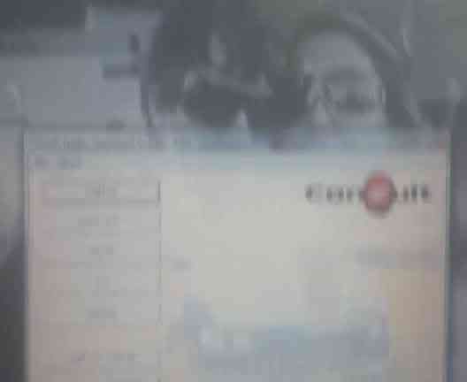

I then tested what would happen if I suddenly connected the MAF sensor in while the car was running. This is what happened
I again tested the car with the MAF sensor disconnected but I used ECUtalk this time and from what I can see the car is in limp mode and wont rev above 1600 rpm in park.
I took the Z for a short drive around my block and the car wont rev above 2500 rpm, but it was driving alot more smoothly and there was no shuttering or drops in idle when coasting.

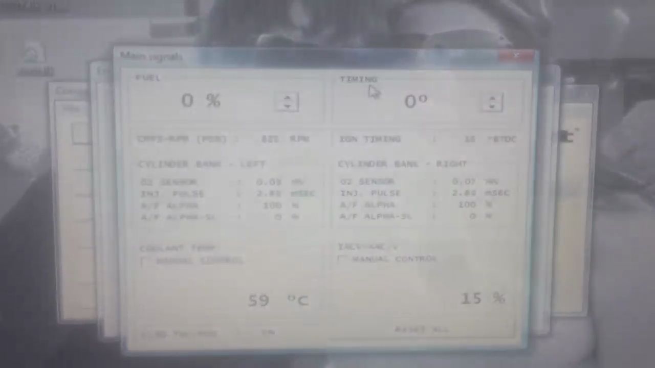

First thing i did was data log my Z's current sensor values from Conzult with my original AFM still installed on the car.
As you can see my idle/shuttering problems hasn't changed much since this whole thing began.

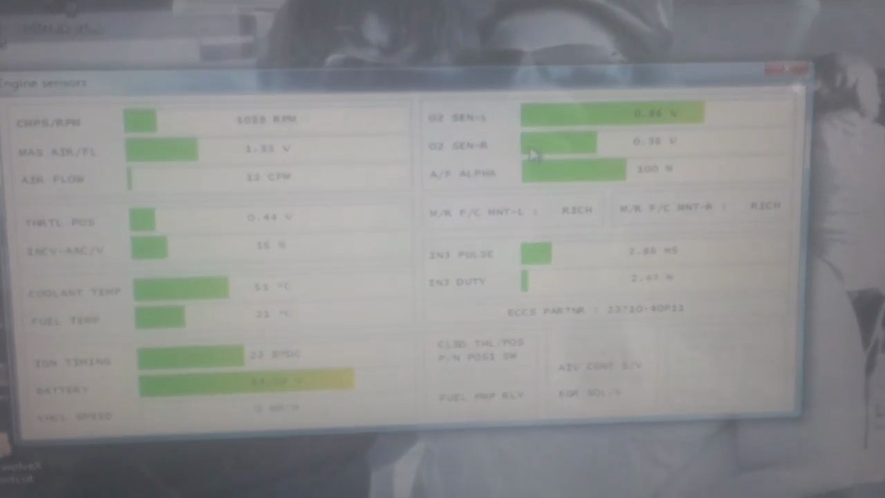

Success, straight away the car felt more stable and the idle was constant and steady. I checked for error codes but found none which was good and let the car idle for a few minutes
My 02 sensors were reading fluctuating volts again which was another good sign and the shuttering had all but disappeared.

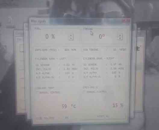

I checked the main signals screen to noticed no massive drops in base idle when switching to the main signals which previously it would drop 100 rpm instantly.
And finally when the car had reached the optimal temperature setting to test the 02 sensors they began oscillating as per normal when revving the car to 2000 rpm.
As you can imagine I was wrapped to see these results and as I had been told by the UK forums I have to now reset my base idle and I did just that. I reset my base idle to dead center at 850 rpm and the car is now purring like a kitten again:D.
