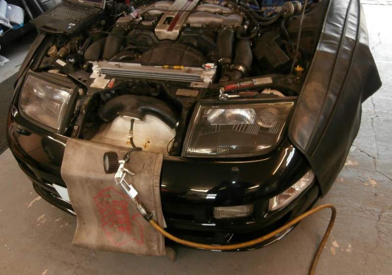

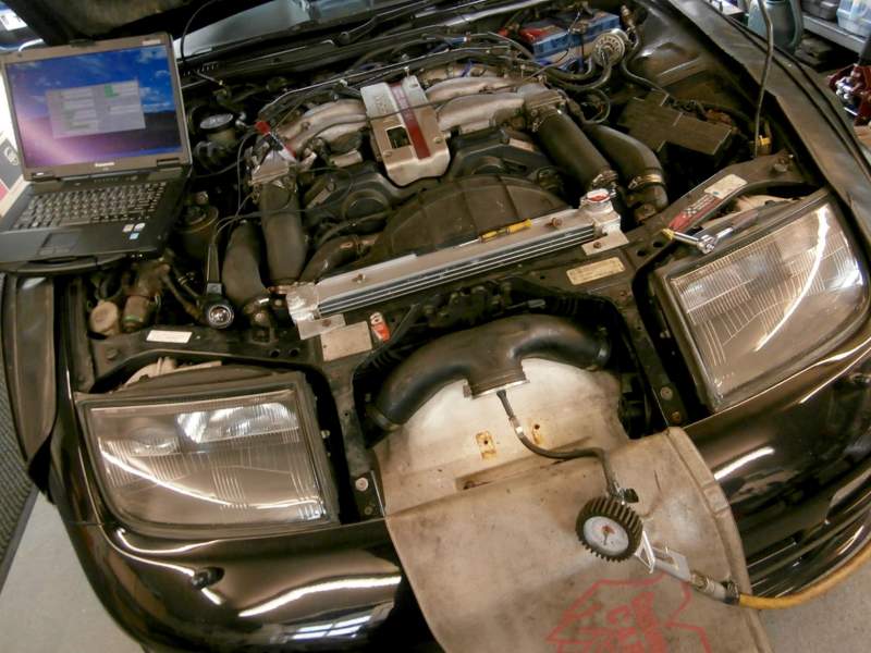

A few pics of my set up today, I use the small vacuum pipe to the fuel damper as a reference point for captive pressure, I do not use the pressure gauge as any guide, if you have a good leak anyway you will not build any pressure, don`t try and keep it under 5 psi either and never had any seal issues.
