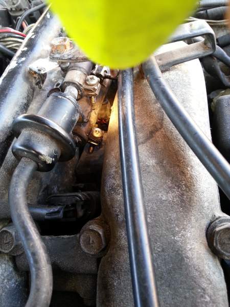

Right i had a good look around with a cold car not used today and turned on the ignition to get the fuel pressure thats norm there when im of up the road. coulnt find anything, but still stunk of fuel so carefully folowed the smell to the throttle cover. took it of and right up the back umoung all the little fule pipes one of was almost not done up at all and was compleatly wet with fuel around that area. right near the back injector treis to tighten up but really need to take of the balence pipe and move out of the way, whilst there i had a good look around and found that were the fuel has dampend the area around first injector plug and were there is some sealant still there the plugs are relatively loose and have green on the tiny plugs that are bearly on the top of the injector. so rather than bodge it iv decided ill take of the balance bar tomorow clean up that area and those little injector wire plugs reseal with sealant and retight up and check all those surrounding plugs.
This then should stop the smell of petrol and make her run sweater when cold espeaslly when and somtimes a tad lumpy. that should also possibly save a bit of fuel especially with a cylinder not working 100 percent all the time. i recon if i was to take out that plug it would be very wet. hope this fixes all then tiny gremlins, thanks for your advice guys and pics to follow.
heres the culprit.
fuel leak pic 1.jpg.
and you can see which one it is, its diff to get to prop. And you can see the other leads under that silicon stuff that are not home properly. thus lumpy running sometimes.
Ah this could well be my problem too then as my problem sounds exactly the same as your shall have a look see at mine too cheers for highlighting this ?

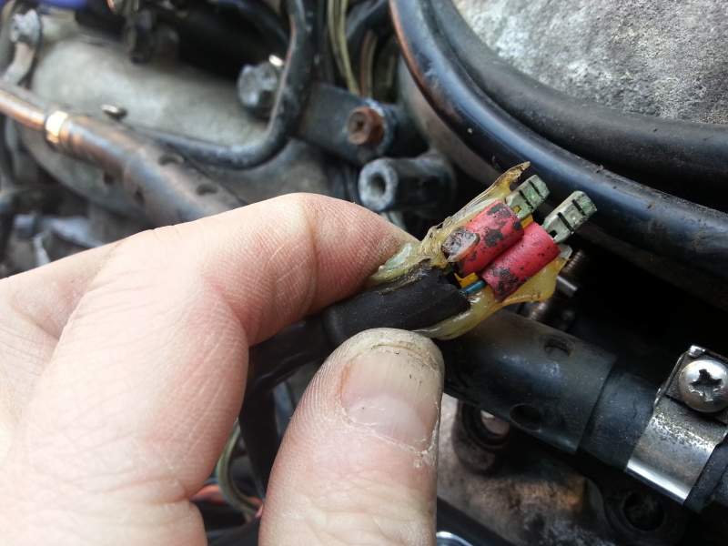

here we are the dirty connectors that were very loose and dirty.
and heres the plug now nice and clean.
now all back together and had a quick run up the road, It was like driving a different car, almost like i gained a cylinder and quite possiblly have. felt so much crisper quicker and not lumpey and no smell of fuel, . cheers guys.
