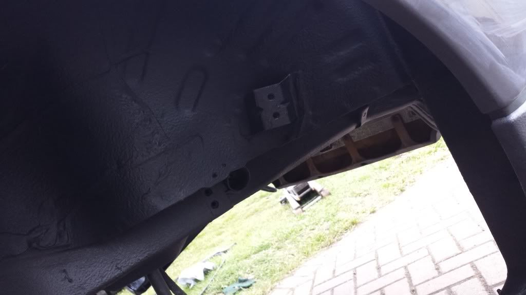

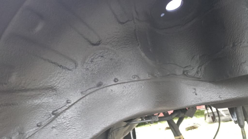

I used dinitrol stonechip, in the arches and under the car, And dinitrol cavity wax inside the sills and box sections.
If you use wax oil it never dries so every time your under it its gonna be messy...
I even done subframes in stonechip, paint or powder coat will chip.
And stone chip I can just keep spraying bits in if they did get scratched off.
powder coated subframe is gonna look crap if you scrape it up...

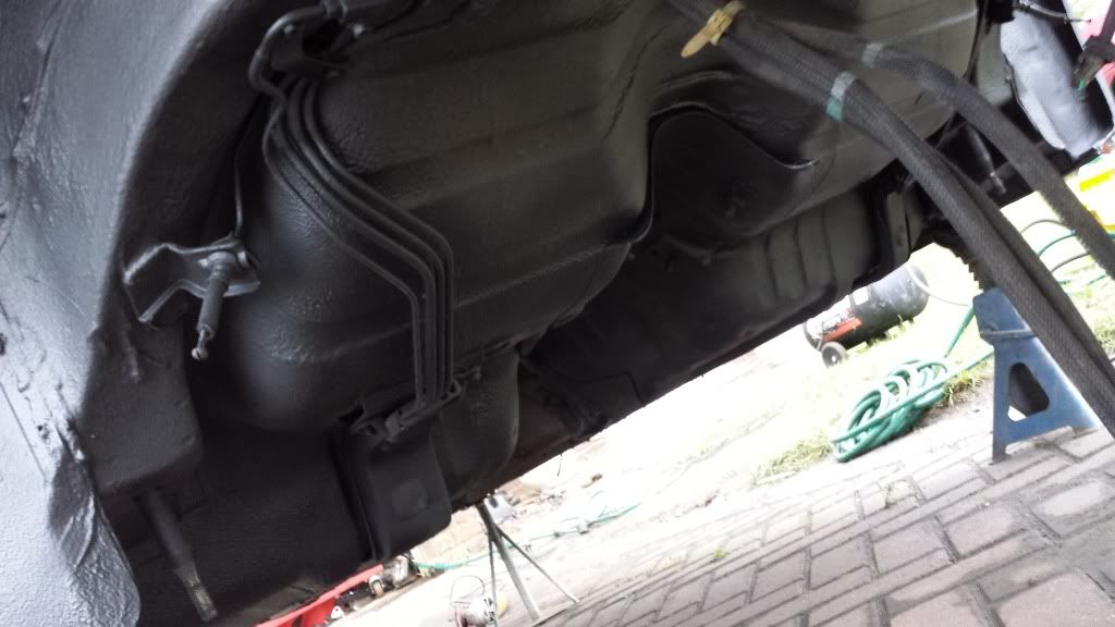

here is my underside, i too will only be using it on dry summer days, so i went for a paint. Will see how it fares in the arches with stonechips but its fairly thick stuff
Ignore the caliper it was there to test fit the brake line :laugh: ....And the scab in the bottom left, i missed it intentionally ;)
