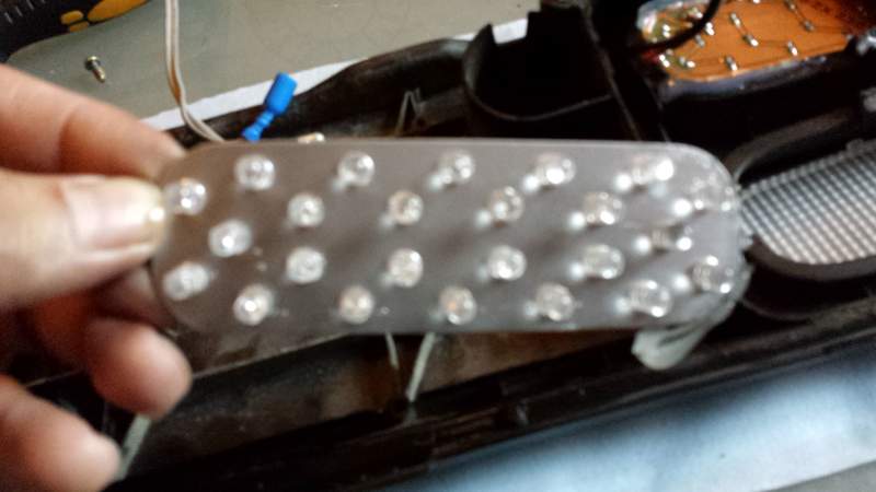

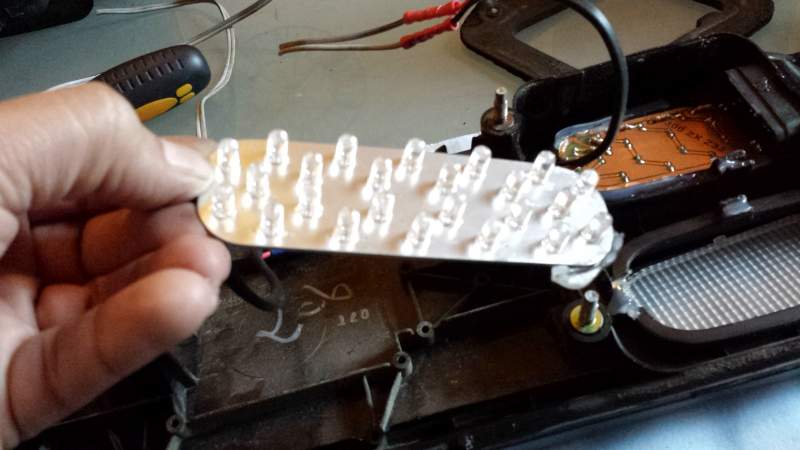

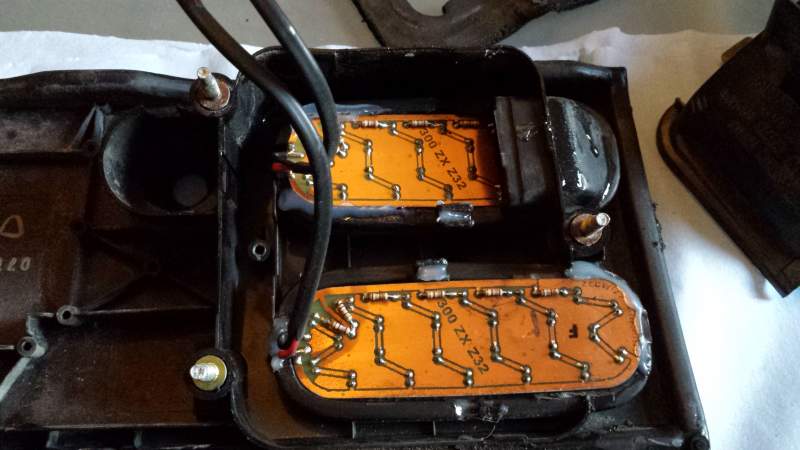

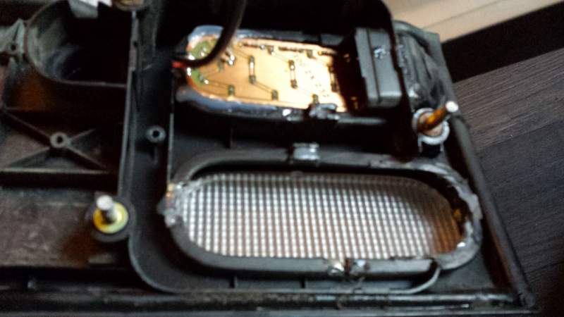

figured id start a new thread, as ive mentioned about my surprise find a fews days ago ive taken out the centre rear light panel and took apart one section to show what it was,
i thought it would've been a simple led insert but it wasnt. from the pictures you'll be able to tell what was done and where, not much to it but the top lense had to be pushed in and glued in place and the edge has been cut away for the led board to fit. the backing cover also had been cut to allow room for the wires
Edited by princeking
A professional circuit board, if nothing else! :thumbup1:
