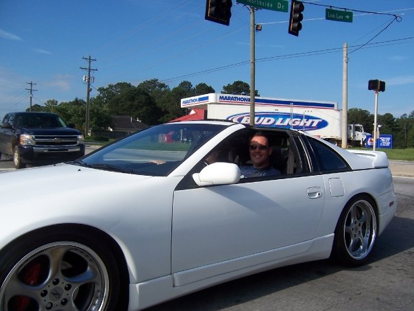

These wheels are the only ones in the world; Nissan commissioned Gemballa to make a wheel that was originally to be intended as a dealer-fit option on the special edition 96 cars which were only sold in the US under a limited run. In the event, it never happened, but those who know their wheels know Gemballa who build wheels for Porsche. These were designed as a spin (excuse the pun) on the OEM wheel. I've driven this car both as an NA and a TT and the specs are perfect. The car sits nicely, the ride is good and of course, no rubbing.
Old pic...
Pretty much as it currently sits...

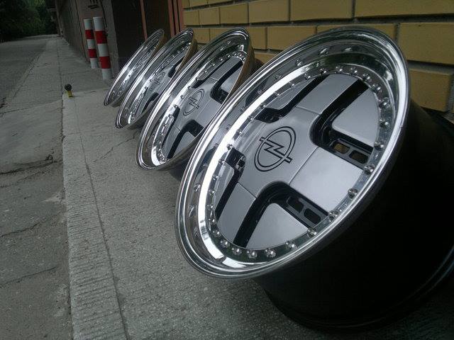

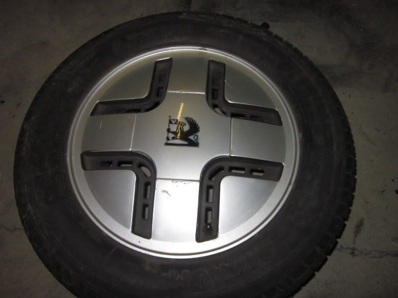

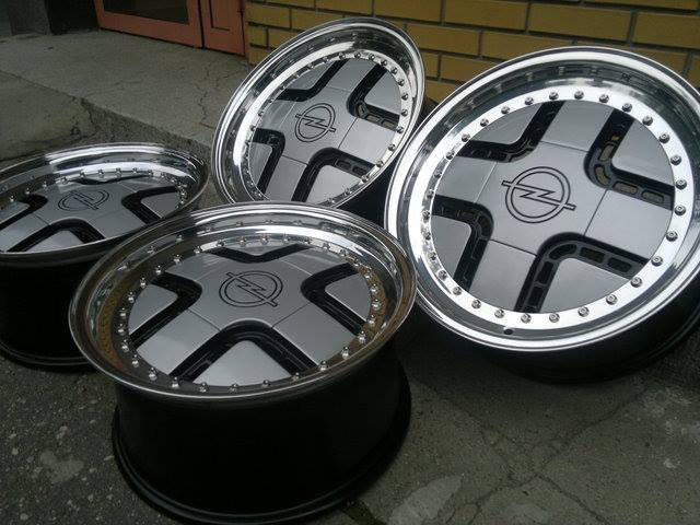

Seriously, how cool are these Opel/Vauxhall wheels!
Before:
After :
