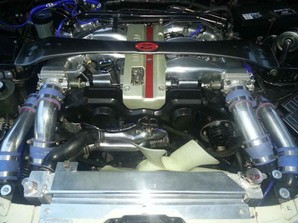

Just a quick photo of my engine bay after the "Lee Dent" treatment. I have to say Lee has been an absulute superstar during this build, i was not prepared for the sight of my engine when i went to pick it up. To put it mildly i was blown away with the quality of his work. The test drive confirmed everthing he had promised, it is a different car to drive altogether, smooth, responsive and with the blitz boost controller setup he fitted that looks almost factory, the turbo response is better than any time during my ownership. With all the deletes done and all the cleaning, painting painting and polished parts installed i couldnt be happier with the results.

Excellent buddy! I saw this in progress and I particularly liked the intercooler mounts, I've seen people leave them dangling from the top brackets...

Well where to begin really I dropped it off and asked Lee to go through the engine and sort all my boost leaks out and check all my sensors, compression and injectors along with a few other bits and pieces !!!!.
Within a couple of days the engine was out and the work started .
Lee found some real horrors under the skin, melted knock sensor destroyed engine mounts holed boost pipes to name but a few so he duly set about making things right.
Couple this with Lees shiney shiney disorder, ( an affliction I share myself), and you can see why my engine turned out the way it has.
Once stripped the engine was found to be covered in waxoyl which was apparently a bit of a chore to remove.
All the deletes were done and all unneeded pipes were removed and the ones to remain were cleaned and repainted.
New hoses were fitted throughout using a mixture of blue silicone and std black ones as required.
Every single injector and coil pack connector has been cut off and replaced with later ones and soldered and heat shrinked to tidy up.
Cas was checked, found to be OK and painted black, along with the timing covers, coil pack brackets and all modified metal pipes.
Polished plenum, front water pipes and cas bracket fitted, new S2 PTU unit fitted hard wired to existing wiring and shrink wrapped. Turbos checked pipework tidied up to work with the Blitz EBC.
Gearbox checked, new fluid, new reverse switch installed. Diff fluid changed, exhaust back boxes polished and transmition tunnel and underside fresh coat of stone chip.
Bumper removed to relocate the HID ballast units under the headlights, Toyosport Front Mounted Intercooler and pipework installed, Twin Bailey dump valves fitted to replace std recirc valves.
Uprated ally rad fitted and st. steel retaining bracket.
Alarm unit relocated under wing to make room near the engine for the solenoid unit for the boost controller.
Carbon canister deleted from under the other wing, checked and bled the clutch.

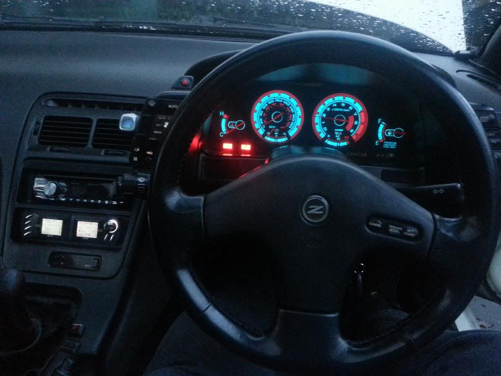

Blitz electronic boost controller, power meter and turbo timer installed in the dash, I have to say this looks almost factory and is very neat with the turbo timer installed in the centre console cubby compartment. Illuminated 99 spec rear panel installed and wired up, (looks the dogs).
