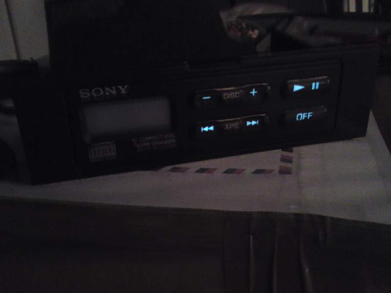

OEM Sony 10 CD Multi Changer in Centre Arm Rest
I didn't know these existed until I spotted Andy Stokes selling one from out of one his breakers on ebay about 2 weeks ago, I just had to have it for £20.00.
Of course it will never work as my ICE as long since changed but it's doing no arm.

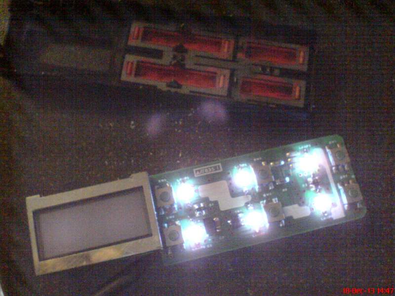

I have already found the wires from the mini din 8 pin plug to light up the buttons and the lcd screen, lights up green so don't know if I'll open it up and change the illumination to red or blue and I'll be wiring it into the sidelight circuit when I fully fit after xmas as it's going under the tree for now.

Sure no one else is interested in this but I did notice the same item above was purchased :sneaky2:, I hinted above about changing the colour from green, it's the usually condom covered jobbies that shine through under the buttons and they did seem a bit delicate so I painted the underside in red and for good measure blobbed a bit on the tops of the bulbs themselves, take my word for it the button illumination is now a subtle red :cool3:.

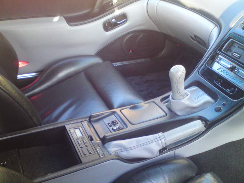

Have one of these in my slicktop (bit of a stickler for optional extras)
Sourced the wiring diagram for the unit and wired it as so that the output signal is converted to Bluetooth, which I have paired with my Pioneer head unit. Utilised the 12V signal wire that the controller sent to the original Clarion Head unit to switch it to stacker mode, wired into a USB port to recharge the Bluetooth sender unit.
No reason why you cant do the same, but wire it to a stereo jack input (most aftermarket head units have these). Shoot me your email address, and will endeavour to find the manual and send it to you.
For such an old stacker, the sound is surprisingly good, and rarely skips, even on our terrible Aussie roads.
