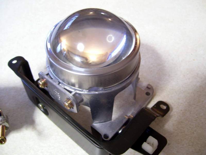

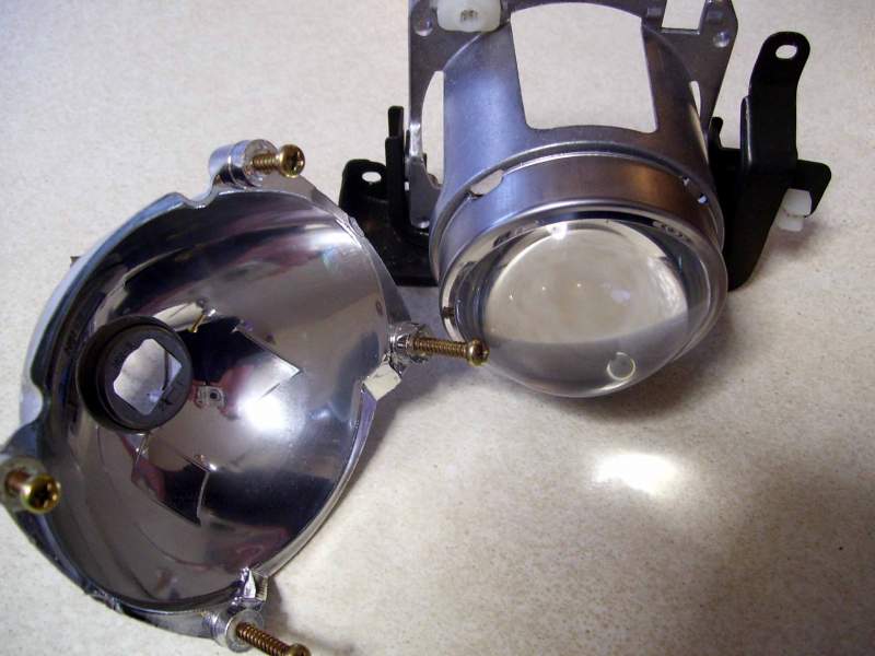

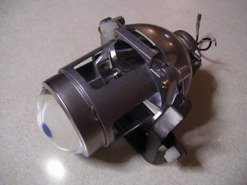

I have managed to strip out the projector lens so I can clean the reflector and lens.
Good news is that the lens comes up quite nice, the bad news is that the reflectors are shot! :helpsmilie:
So would definitely appreciate your offer mate. I will pm you next week and we can sort a price out etc'
In the mean time, if there is anyone out there with some smashed/scrap lights knocking about with salvageable internals, please let me know.

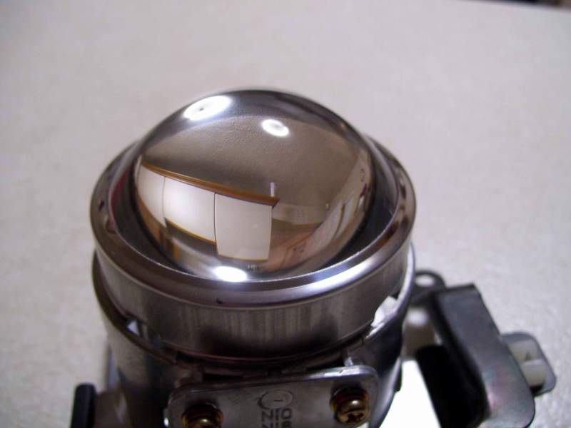

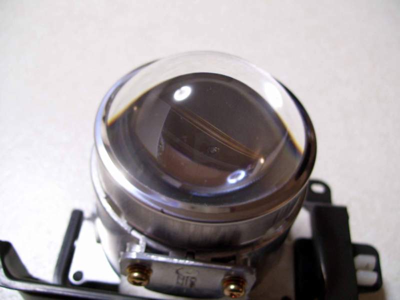

A couple of pictures with the lens finish polished.
Came up quite good.

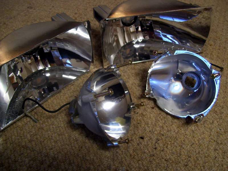

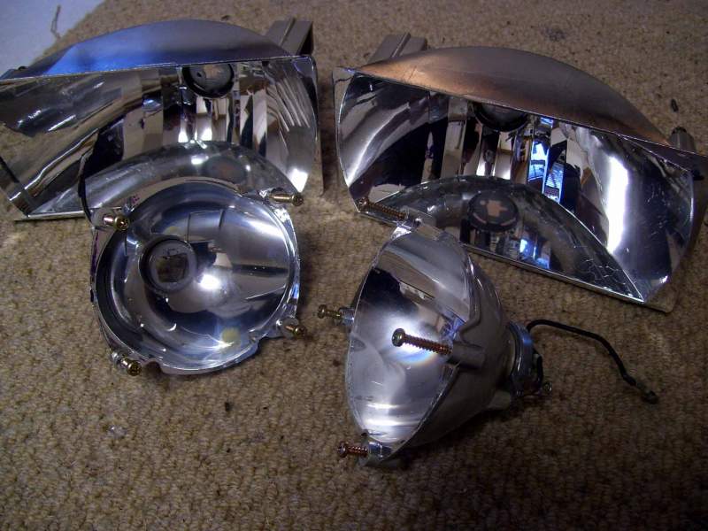

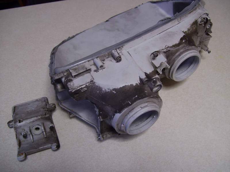

Well, I have stripped both headlights now and I think the internal reflectors are all shot.
Does anyone know if these can be bought seperately as new?
Alternatively, can they be re coated?
I have tried polishing but to no avail.

I can't see why you can't get them re chromed... and no they aren't available as new separately.
I guess you have to decide if you want to buy another set it good condition or get your ones re-done..
I have a full spare set and can check them out to see how good they are.. (but you're already had a offer of a full set).

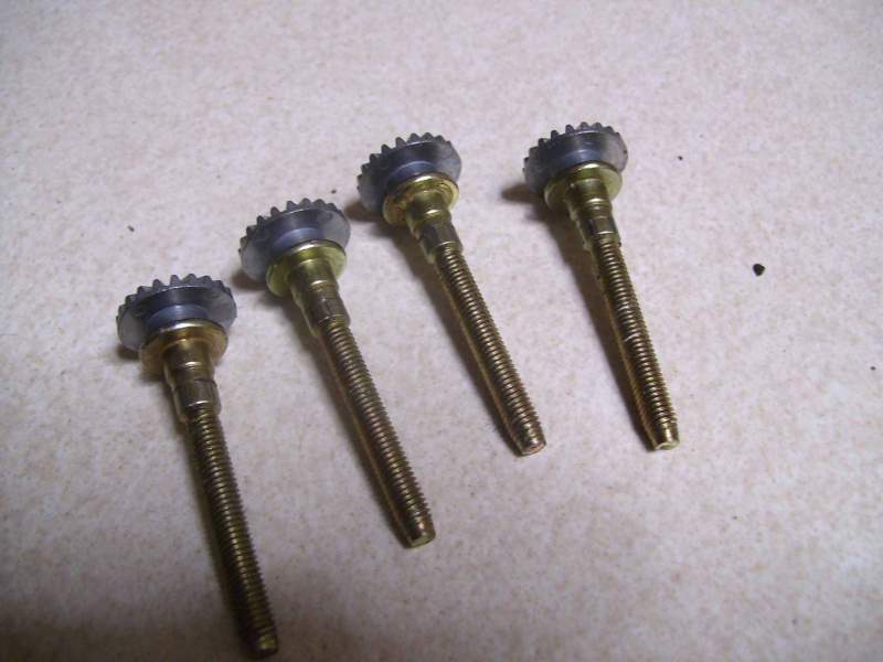

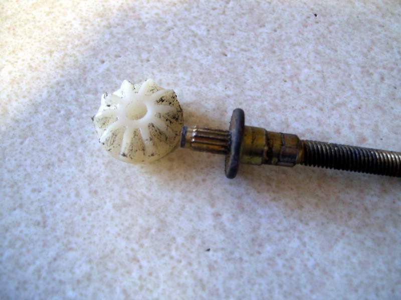

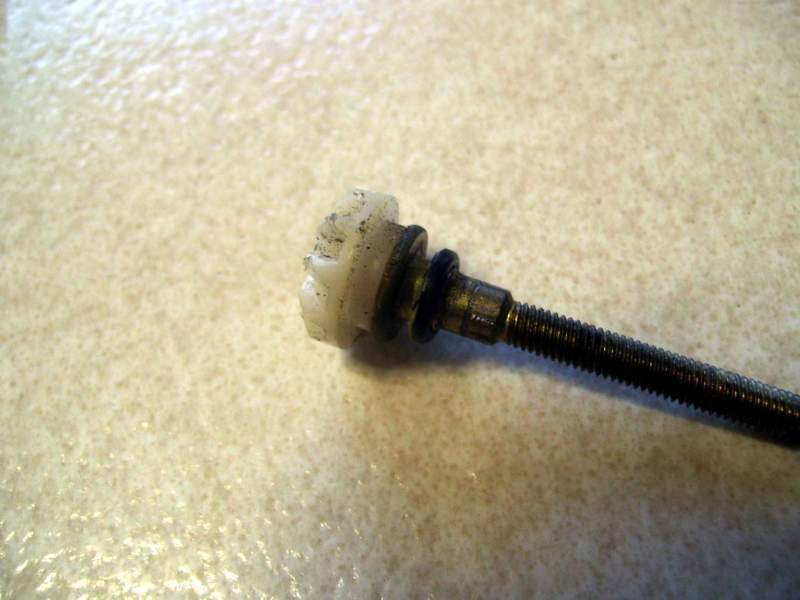

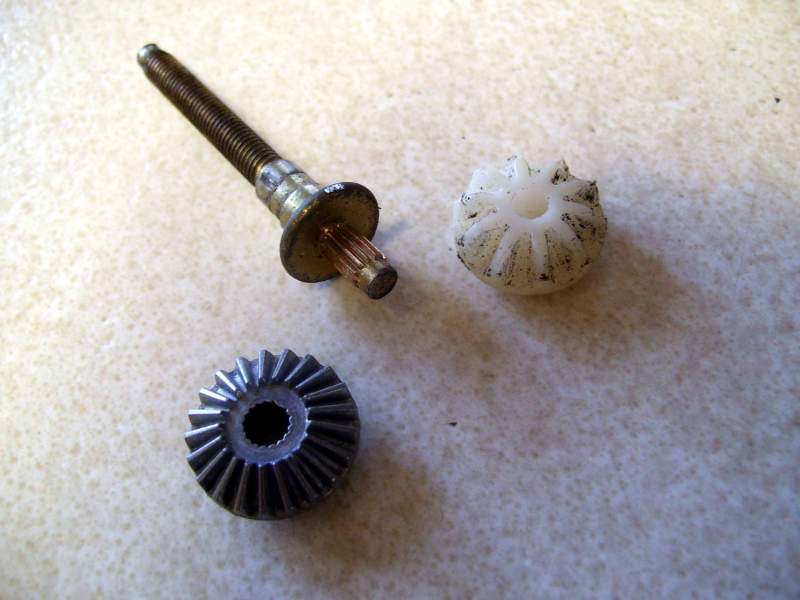

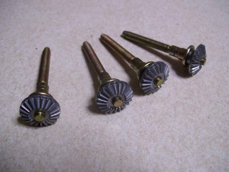

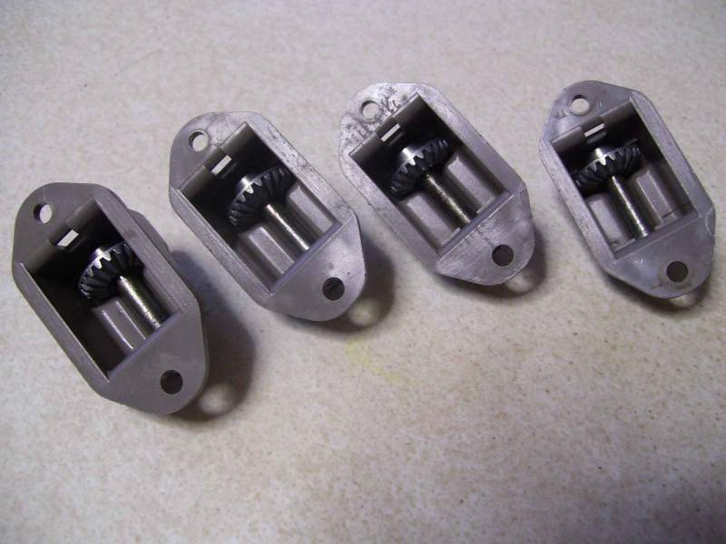

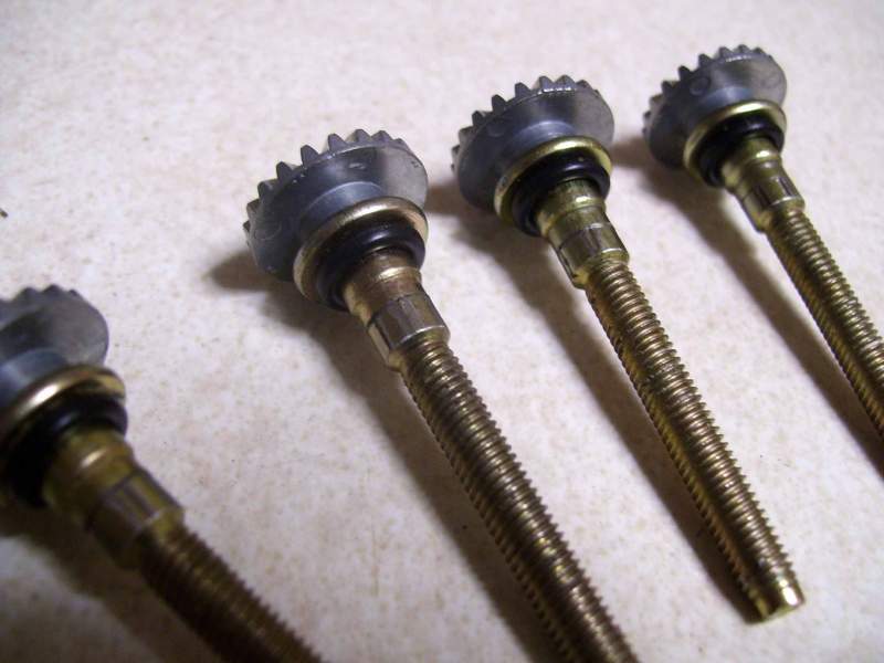

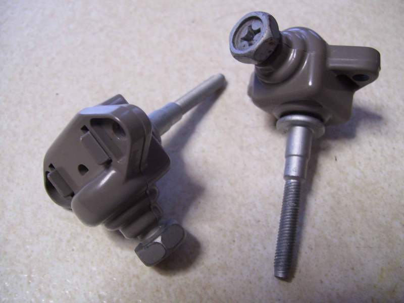

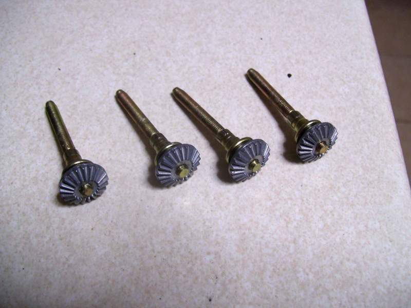

I thought as I have come this far, I might as well swap the plastic adjuster gears for the steel ones I bought a little while back.
I have read a couple of how too's and rather than risk breaking anything, I dismantled the shafts so as to make it easier to press the shaft from the gear.
I have not pressed the steel one on as yet, as this is just a scrap shaft I was practising on.
The plastic cogs do just lever off with a flat screwdriver, I use a long reach 1/4 inch socket to tap gently the new cogs on with :thumbup1:.
Put a blob of grease on them also.

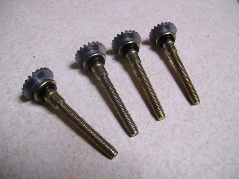

Totally understand where you guys are coming from, It's just that I wanted to check,replace and re grease the O rings at the same time.
I thought as I was not looking to tackle this job again any time soon, I might as well go the whole hog.
Looking forward to shimming the gears soon so as to get the best mesh also.
I think I will pack the housing with grease when I come to finally assembly.

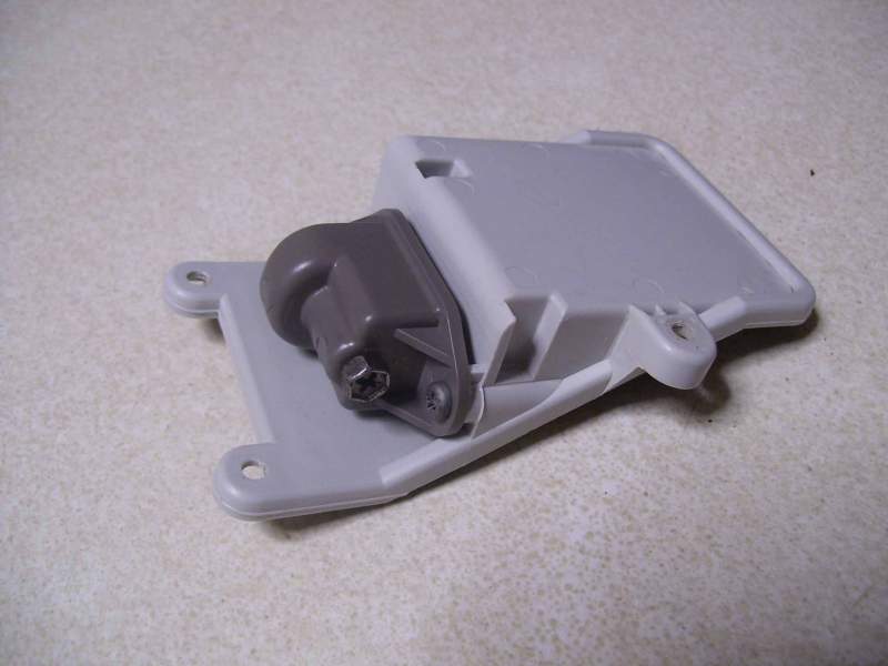

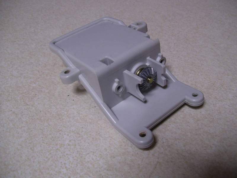

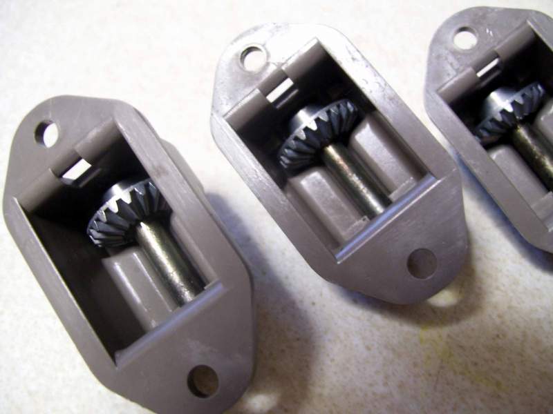

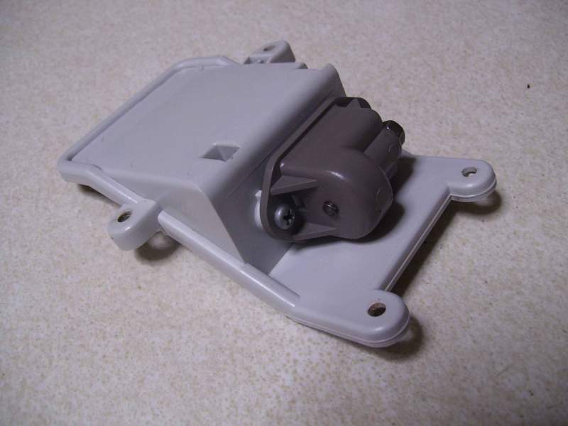

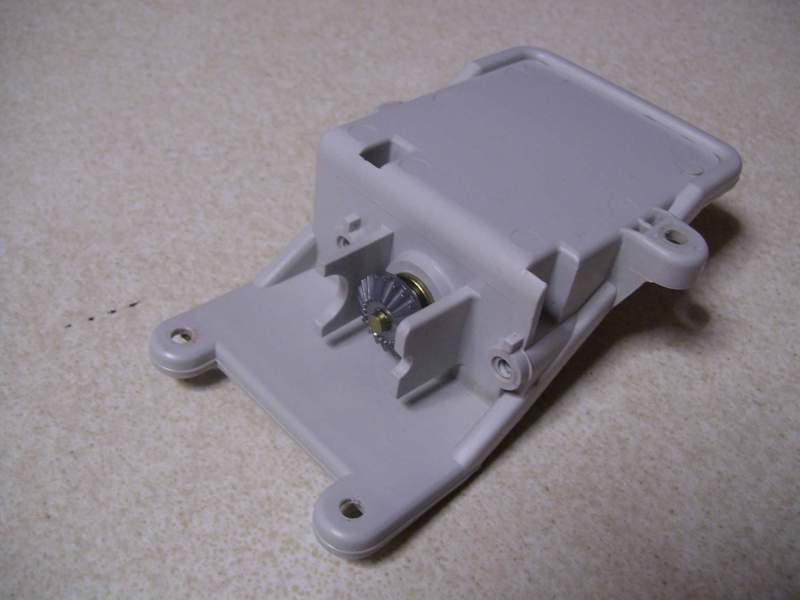

At the risk of becoming boring, I thought I would assemble the adjuster block ready for final fitting.
Turns out that there will be no need for any shimming. If anything, they are a bit pre loaded when built up on the housing.
I will probably run them in a bit by hand prior to fitting the headlamp. (just to ease the tightness)
Also, I will pack them with grease on assembly.
