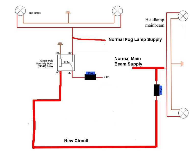

This is something I found from another forum, can any auto electricians confirm this will work for me? Thanks
Yes that will work but it's showing main beam and not dipped, you decide which you want your fogs to come on with and have this wire sent to position 85 and when you trigger, the relay will energize between 30 and 87, thus giving power to your fogs :cool3:.
