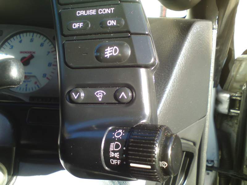

They should have their own button incorporated into the light switch on the right hand pod. If yours have been replaced at any point in its life, it's likely it could have been replaced with a JDM pod which is just the light switch on its own.
Rubbish photos, but you get the idea....you can see the button on the headlight switch of the UK labelled pod.
UK:
Jap:
Mines the other way, got a UK in mine but the pod is so mint apart from the unforgiving SORN dust :wink:.
I don't have cruise either but couldn't live with a blank :no:.

To answer the question, on a UK spec car, there is indeed a separate button for the headlamp washers - on the headlamp switch itself as posted in the pics above.....
