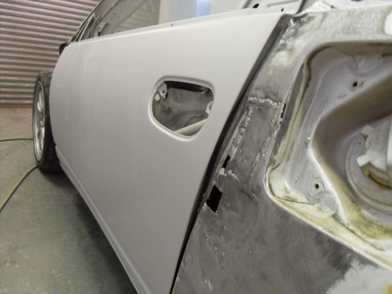

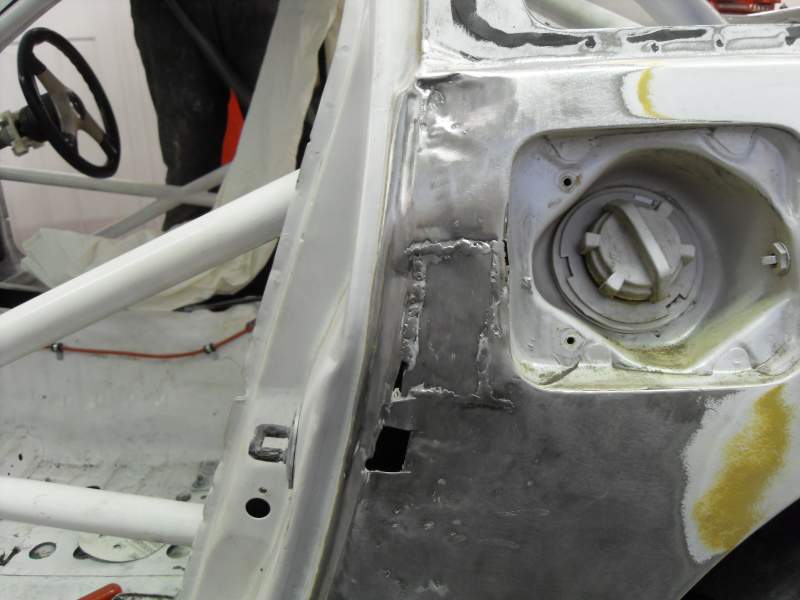

This what was hidden under alot of bad filler

I cut out the plate that had been welded over most of the hole ?? used a slide hammer to pull the panel edge back out and used wiggly wire and the pin puller to get the rest out .

I trimmed it up and made a new repair plate and tacked it in , gonna finish it later .

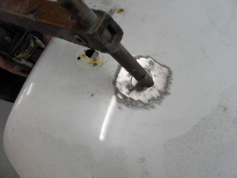

The spoiler holes have been welded up but darren used the spot welder cos you get far less distortion than mig welding them .

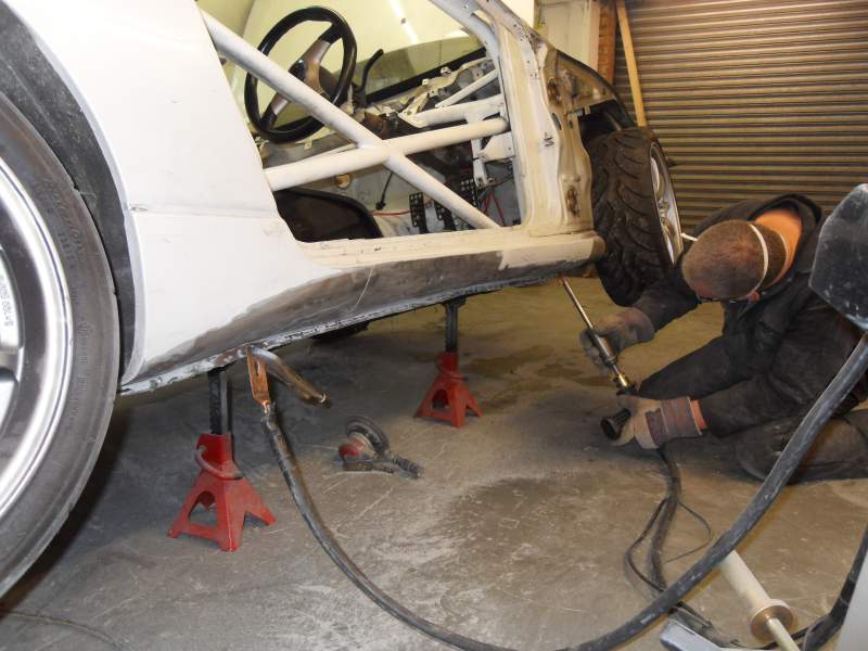

Darren hard at it with the pin puller repairing the damage running down the O/S sill
