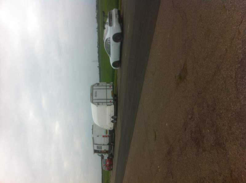

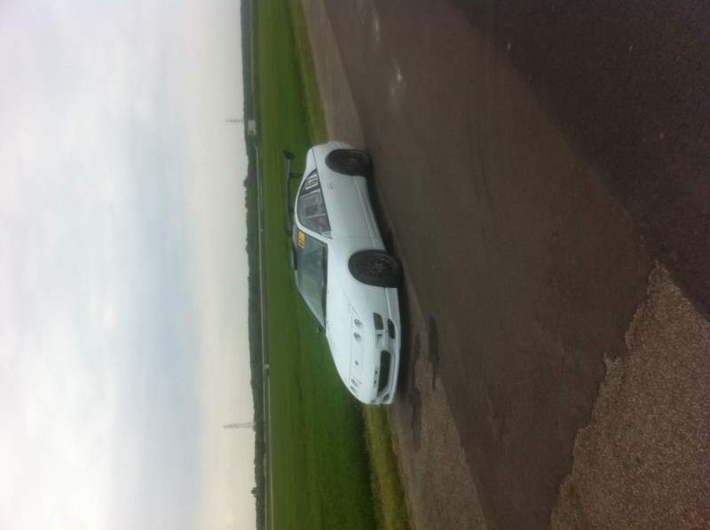

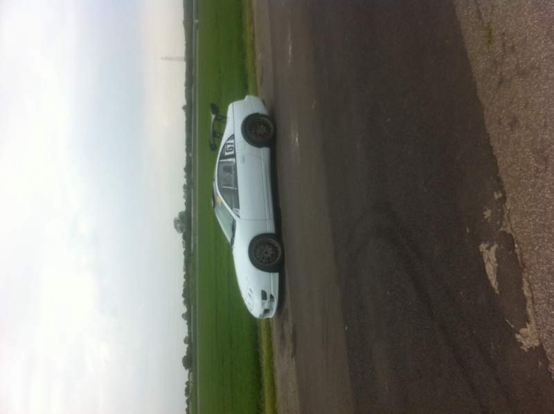

Testing today there was some pretty exotic cars. A fair few must have been priceless as Dan was busy taking photos. Once I got up to speed I started to hold my own despite being down on power
https://m.facebook.com/story.php?story_fbid=692638107517326&id=100003134288593
I will be going to the Lotus test track at Hethel for another sprint in a couple of weeks but hoping for another couple of hundred horses :-)
