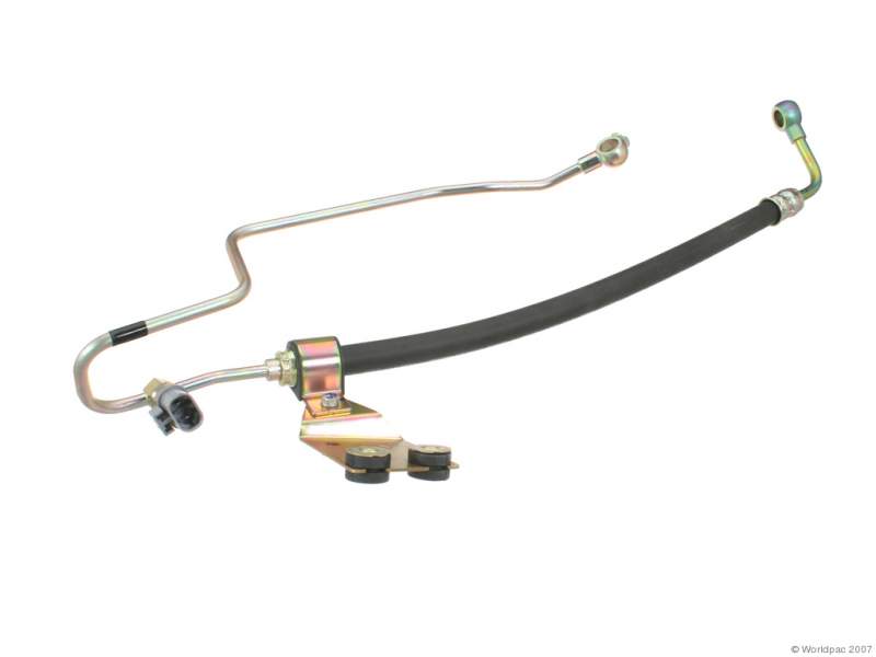

From your description Im guessing you are after this..........................
As your car is an grey import then I suspect that Nissan UK wont hasve this item in stock.
Probably not Nissan Europe either.
So it will be a special order from Japan.
A hose from thr US will have been for a LHD car and this part is probably L or R specific.
A call to Mike will confirm.
Be sitting down when he quotes a price.

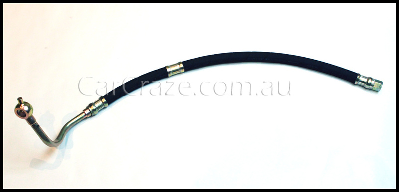

its not quite like that but its the closest to it iv seen cheers :) I think the car has now got to the point where I need to either bin it or be prepared to spend some serious cash I think it needs sills for mot too.

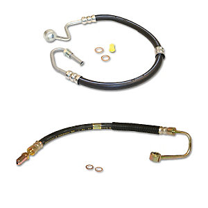

its neither of those two lol the bottom one is the one I got from the states I think what z32bolt said is prob best idea I had thought about having it made looks like that might be only option.

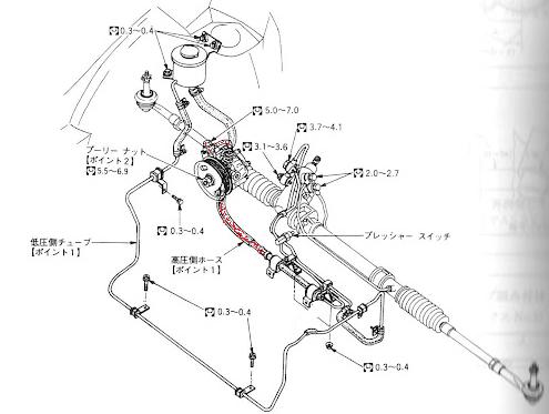

Hi, David.... I have the diagram for the power steering pipes if that helps.... Russ
nope lol I have searched the web and carnt find nothing like it :( I think im unlucky as had a few issues getting parts for my particular car befor parts that are meant to fit don't if I knew the part numbers I be able get as Amayama in japan provide most parts for car ive looked at that one and its meant to be the pipe shaded red but when I go on to anywhere to order comes up with pipes that look nothing like mine :(

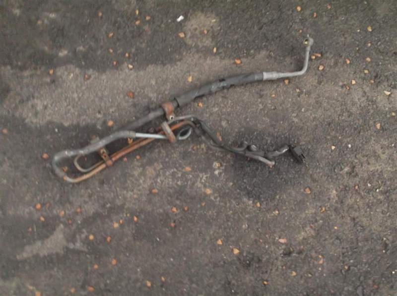

<a href=100_1675_zpsb7e02f6f.jpg' alt='100_1675_
let me know if this works pic of pipe
You can undo the flexi section and reuse the hard pipe from your old one......
It looks like the part number is 49720-30p00......
Russ
Russ
And which is clearly shown as part of the whole assembly including hard pipes that I posted earlier.
:bow::bow::slap:...... lol
I was guessing David didn't realise that the pipe he has and was looking for is made up of multiple pipes.....
