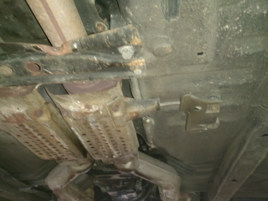

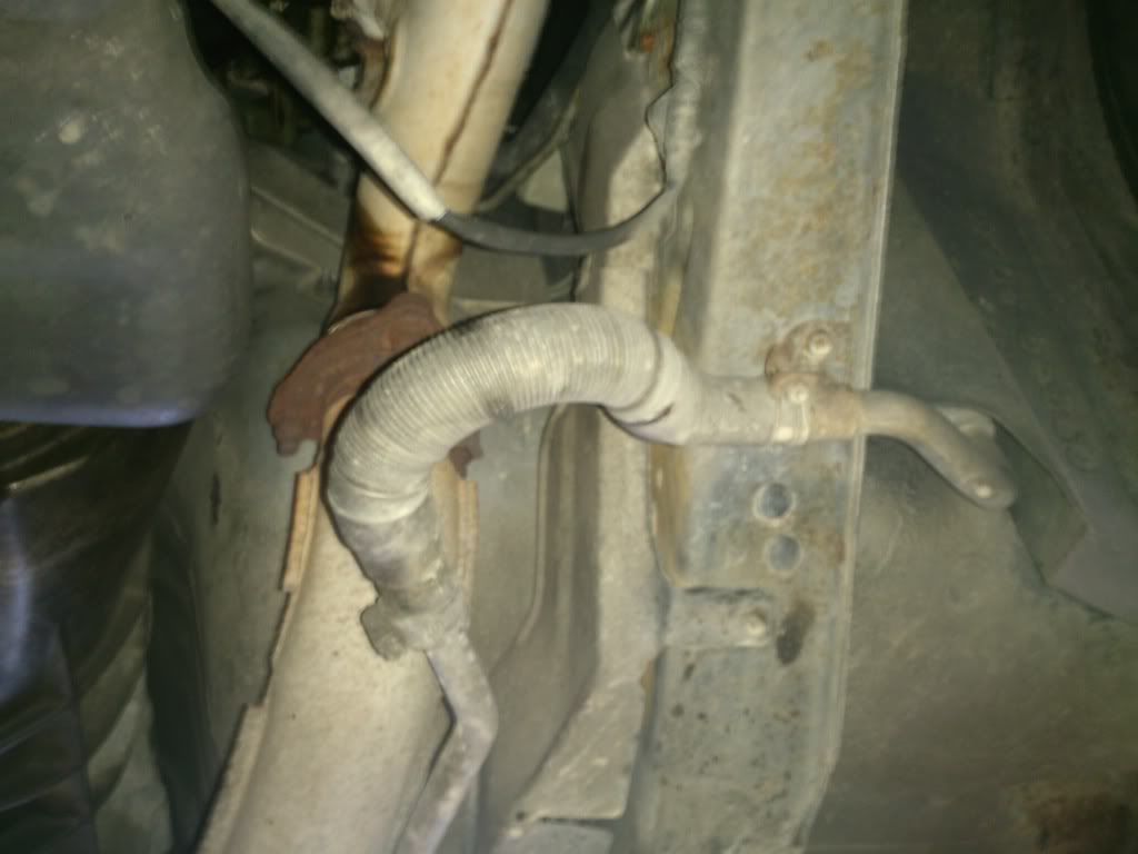

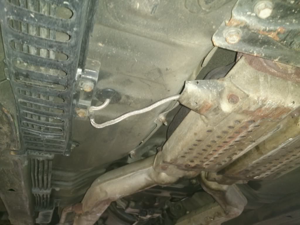

Purchased a Japspeed decat for my JDN NA online, came yesterday, took it to the garage to be fitted today,
And long story short they couldn't do it.
They put it down to there being no holes in the de-cat for the lambda sensors and also the EGR (I think they said not 100% sure) would also cause a right problem and would take quite a while to take out to fit the decat pipes
So I Was wondering did anyone else have this problem? or has anyone fitted de-cat pipes themselves and found it easy/hard?
Help would be greatly appriciated, I have a couple of bad pictures below that show the lambda sensors and egr i think
sorry like i said, terrible pics :sad:
Thanks
Alex

The Lamba sensors are in the Manifold on an NA, not in the decat pipes. They may have confused the cat temp light sensor for the Lamba sensor. This is not required without a cat.
The AIV pipes are in the original cat pipe, but you can just block these off. They are not required.
There are no lambda sensors in the cats.
Those are post cat temp sensors. You can just cut the wires and tuck them out of sight
If your garage was any good, they notice the lambda sensors are fitted to the manifolds.
Yowser beat me to it.
Also if your car is or was an auto then the drivers side pipe will need some thumping with a lump hammer on the angled turn to make it fit.
Na its a manual so thats good, and you confirmed my thoughts that they were a tad clueless
Thanks
Just fit them yourself, cheaper and it will be done right. It's easy peasey.
so you don't need the temp sensors any more ? you say cut them off will that not throw a fault code ?
They are not connected to the ECU, just the dashboard light. Don't cut the wires, just push them back up through the floor holes and leave them under the carpet. Obviously block the hole with a new grommet.
