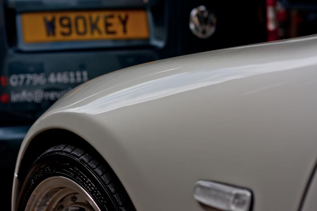

Your front arches will need working with that offset and width - quite a bit I'd say - almost as much as the rears will!
This is a +20 with an 8.5" wheel....
fronts will need a good roll and removal of liners
rears are going to need a lot of work, I mean a lot ....
