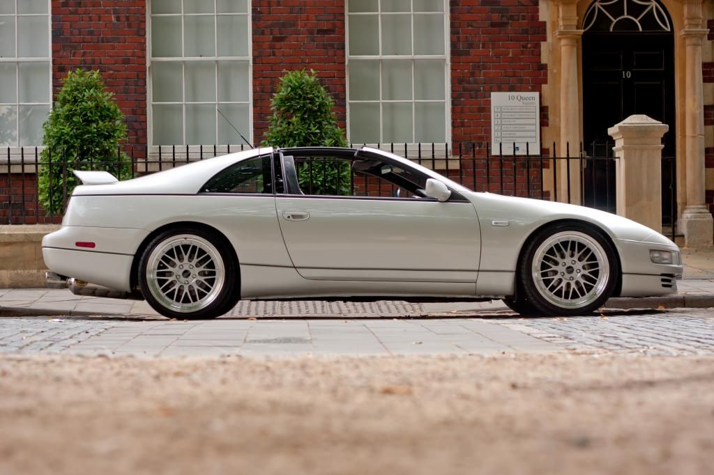

Aye. ET25-effective here on a 9.5" wide wheel. I'm running 275 x 30 on a 19" wheel on the rear. Only a mild drop on Tein S-tech however.
They do look superb and very "factory". I really like that you've not gone mad with the drop. Looks just right. Do you reckon that your ET of 25 works with the 19s (that doesn't seem quite so easy with 18s?) or is it just the right tyres and camber?
Thanks. :)
It's a combination of everything over the years. I have fully adjustable camber on the car and spent quite a few years playing about with offsets and tyre and wheel choices (I've ALWAYS felt and strongly believe that all the Z32 needs is a nice stance to set it off and little else). I've gone as far as I think I can go with it now and pretty happy with how it sits and its overall stance. I kinda like the 'OEM+' concept and it's nice to have a slight gap between arch and tyre (that's equal all round) rather than tucked underneath. Here's a side view showing the drop and the equal gap between arch and tyre.
Wow. Now that's the picture I'm going to use to set up mine (hope you don't mind). There's a place for "slammed" cars and "battle stance", whatever that actually is and I do get what they're going for. But the sacrifices in use-ability of the car are too much for me and anyway, it turns the cars into "show ponies" and instinctively I always think cars should be used.
The thing most forget is that going for "OEM+" is IMO, always the hardest to do and get right. The bottom line is that the setup needs to look right AND work right in all the circumstances you (the owner) have chosen to put it through.
But with reference to your car, the old engineering phase fits nicely - "if it looks right, it probably is right!.
Thanks and feel free to use it! Hope it proves some use to you in your quest! I completely mirror your other comments too.
