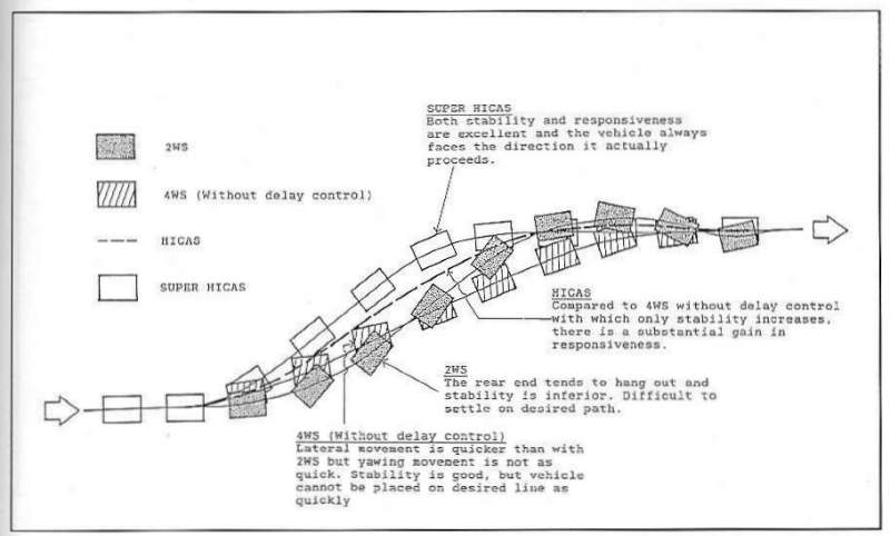

I was just wondering (after watching that 300ZX video that princeking uploaded) why is the HICAS eliminated seeing as it looks so clever in the promotional vid. Nissan must have gone to all the effort of fitting it for a reason one would think. Then we take it off again?

Without too much detail, hicas only really helps in an over taking or salom scenario. When we talk about corners not so much. Sadly it creates excessive play often, equally many find it a bit dim witted. You tend to react quicker that it does and an over correction occurs. It's personal choice in all fairness, but most Motorsport focused z32s have deleted it.
The 300ZX Turbo, with its considerably higher speed potential [than the NA], needed Super HICAS if it was to achieve the ambitious handling and stability standards they had set themselves.
Nissan Testing Centre was happy with the handling of the NA without it and that
the real benefits of the rear-steer become apparent at over 120mph
Now all that's as maybe but there are two facts here. 1) Nissan did "de-spec" the 300ZX throughout its model life in places (just one example being the aircon controls) and 2) never took HICAS off the TTs. One would have thought if it didn't have a good effect, they would have saved the money.

Heavens now I am even more confused! The graph looks like in the Nissan video. Should I put HICAS back on?
