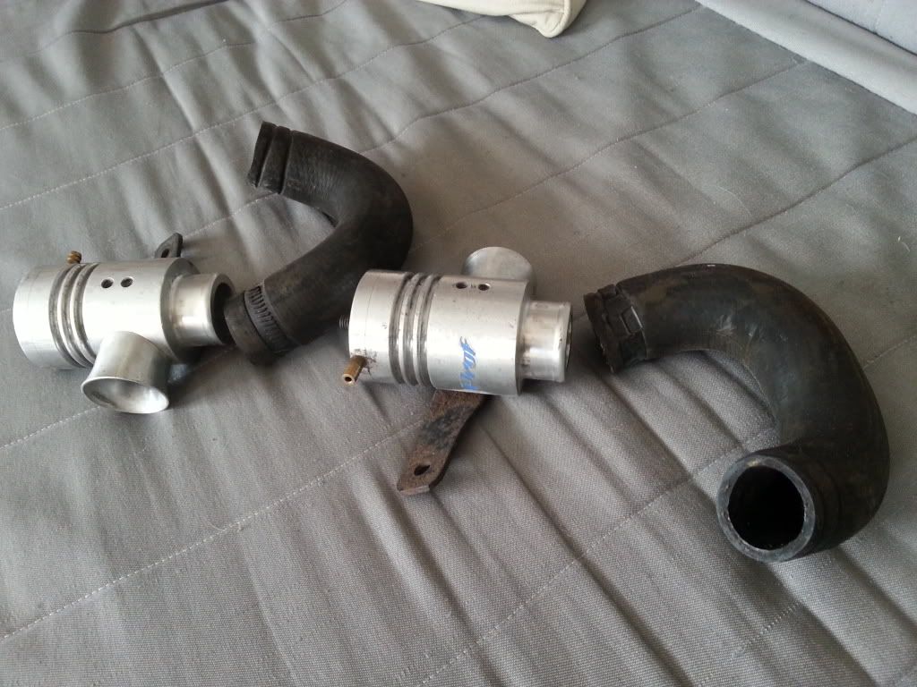

Hi, I bought these on here a few years ago, I've tried looking on how to fit them but every guide seems a bit vague.
I bought them as Bailey dump valves but since found these are called 'Professor Sheepdog' BOV's.
Is it the same fitment?
They look like bailey copies, and they already have the bracket attached to them needed to fit in the correct position by the look of it....did they come from an existing 300 fitment?
I read they're really rare jap import things.
Supposed to be good?
Not sure how true that is.
Yes it's off of somebody on here.
are thay duel or single piston ? you can get a fitting kit from baily so you can fit them
They go under the nose panel. Remove your stock recircs, use the bottom hose to connect to the bottom of the bov. the top one that currently goes back to the maf pipe work above needs to be capped off. Finally the vac line needs hooking up from the old to new. Done.
Had a set of these on my jap import, they are single piston and worked pretty well. replaced them with diaphram BOVs.
