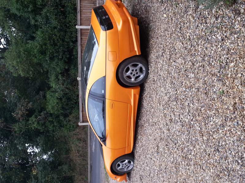

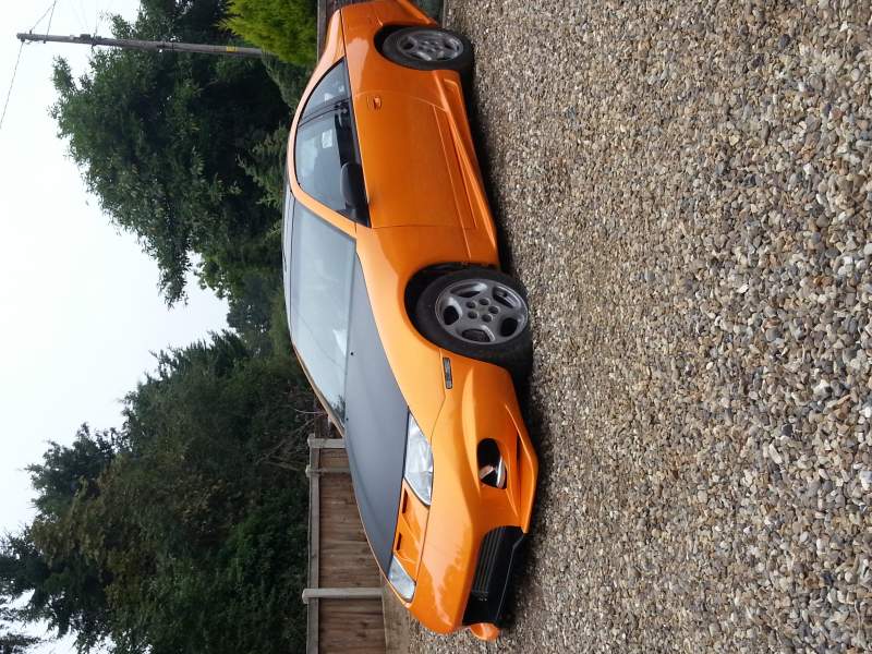

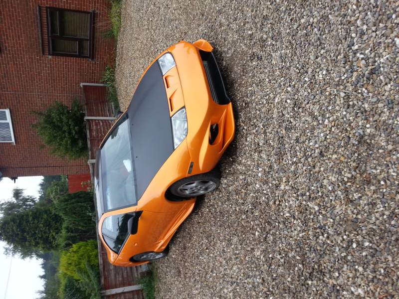

now all i got to do is put the wheels on rear spoiler, but funds are now gone so the rear wheels and mot ect will have to wait another month. Im so close.to getting her finished.buy the time comes itll be snowing. But looking on the bright side at least itll be ready for spring next year.right ill go and polish the rear exhaust and fit them, oh and i still got to do some wiring yet. Laters.

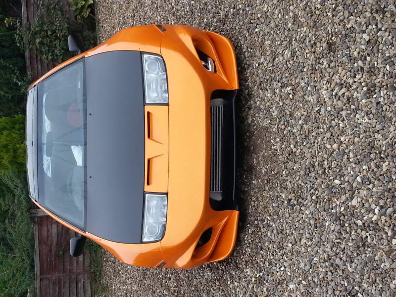

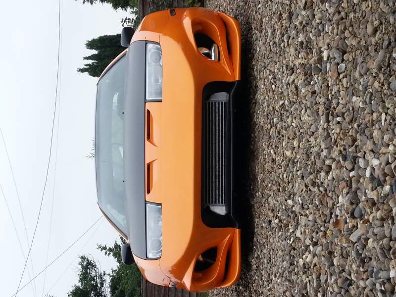

yer well i have changed the front bumper . I have tacken of a good two inches off the botom and got rid of the side bits that bulk out so less obtrusive and not in your face and cut them bits of and moulded and blended the sides in.
