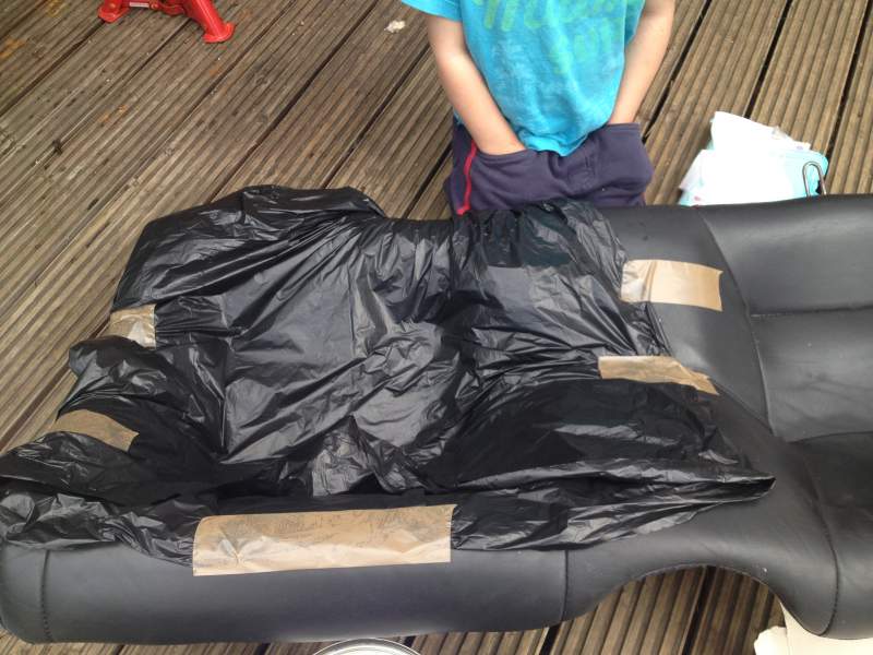

My little boy helping put the plastic bag on the seat
Bag secure.

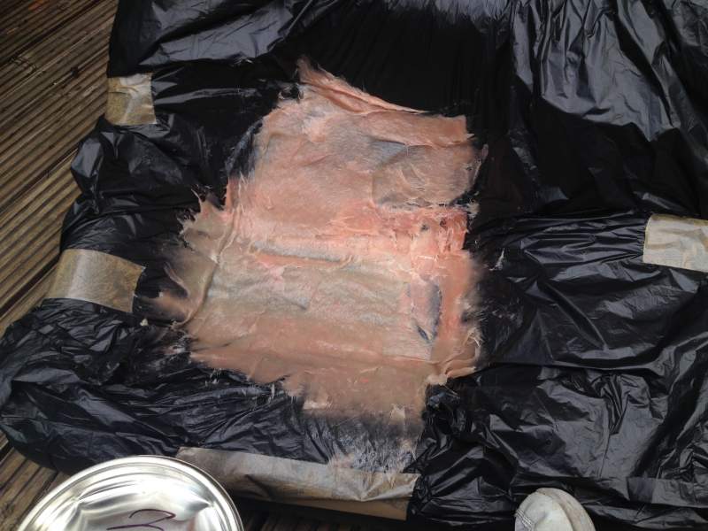

Slap that paste in and let the weight of it, form the shape of the seat, i found starting at a corner then spreading it out the best way to get it going with out it taking the bag with it.
Once it starts to cure, it pretty much stays where it is.
One base is now done, just need to let it dry fully and attach it to the seat once ive tided up the edges.

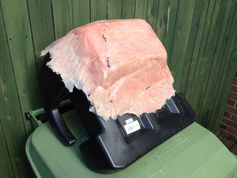

Anyway, once it had cured enough to be handled, i removed the bag from it and test fitted it while waiting for it to cure fully.
Just need to clean up the edges and attach it now
Will update further once ive got it attached to the seat.
Thought people just put a small pillow in the bottom bit.
Doesnt really grip the seat though, well i tried attaching it to the seat but the seat has too much flex in it, which is a shame as with the base attached, it holds the seat very firm, think i might put some area's inside it and screw it to the base of the seat instead.
update on project car seat, having taken two molds of my rear seats and attached the fiber glass mold to the bottom of the car seat, here is the end result
the seats now sit perfectly in the rear seats, with no movement, bloody awesome parenting :D
