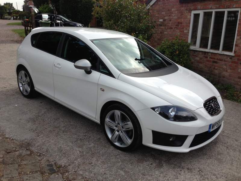

Same MK. This is my second MK2 and it's a facelift also. The first one I had was just a 1.9 Sport not long after they were first launched. Got rid of it a long time ago, but I didn't have a SINGLE problem with it. The MK2s are ultra reliable and very well made. I prefer them to the Golf, especially the interior and general styling. The FR is fantastic and the one I have is the 170bhp and doesn't hang about. Well sorted chassis, especially with the optional 18s that mine has and simply fantastic seats.
This is exactly the same as mine, same colour, wheels and everything. Only got it today and I'm over the moon with it, such a lot of fun, but seems to cruise well too. Smooth, responsive and pokey engine, but you can really throw it about and it takes quite a bit to unsettle it.
