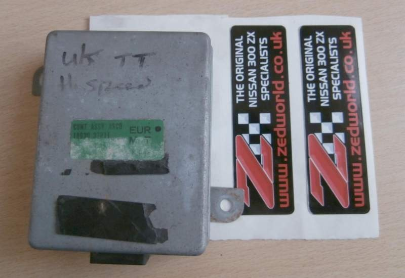

It lives in the pax footwell next to the engine ECU.
You got a pic of one???
I might have one in my box of ECU stuff but I have no idea what it looks like as I dont have stuff like that on my car.

It's baz selling it on eBay
Sure is birdy boy ;)
Sure have chap...
Thanks!! I will have a look.
