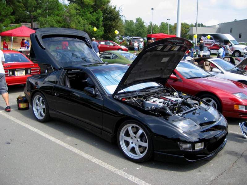

They are my favs, Philp has those on his gorgeous black Z that looks similar to this:
very nice indeed
