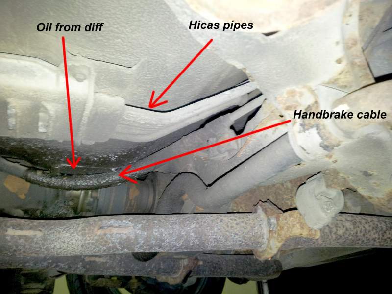

Hi guys, I need your help. Found an puddle of ATF oil under rear driver (your codriver) side. Here is a picture:
D0AJO46_-Unq8b8iPzdRy7soFKTL67Yde3_GPQzY3wI?size=1280x960
I'm guessing HICAS or differential, could someone point me in the right direction?
Firstly I have added some detail to your picture and as you can see the oil is from the diff front pinion seal, the other item close is one of the handbrake cables and the cluster of pipes which are dry are the hicas ones.
As you mention our passenger side is the leak area then its likely the hicas pipes further forward than the picture is where the leak is, in fact there are some clips over the pipes that can some times trap moisture and cause the pipes to rot through, if it is part of the steel pipe it is quite simple to cut a small section out and fit a new piece in ( high pressure rubber with new clips).
[ATTACH=CONFIG]72931[/ATTACH]

wow, Jeff thank you for your time and explanation. It's much clear now, I was completely off track. I thought that handbrake cable was HICAS line and that oil on it was the oil coming out. Talk about misleading :) So thank you again. Obviously I will also need to replace diff front pinion seal, one more thing on the list!
Tomorrow I will jack the car and follow HICAS line to find the leak.

Yes well of course that I am grateful to you too. It's just that Jeff went that extra mile to draw things to me. But yes, thank you too. :)
