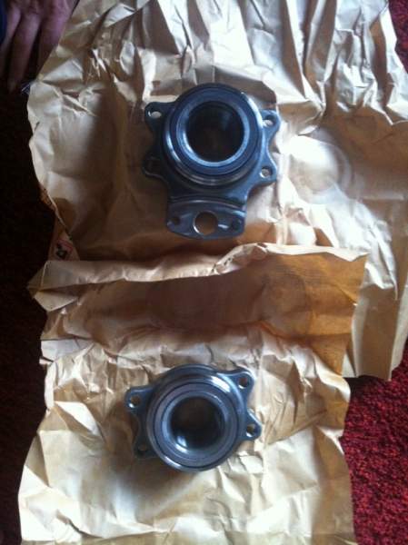

Can you take a look inside.... and tell me what you see?
Both are RH and LH as supplied by Nissan.
The top one (RH) is handed by a pin. Which i am aware can be pushed out and swapped over (correct?)
The bottom one (LH), I thought was wrong and I got re-supply. But they sent the same one again????
Shall I just order another RH and change the pin? Or whats going on?

rear wheel bearing ?
top one is for 300z bottom one isnt
OOOOOOH yes it is!!!!!
I have some used hubs here just like it
strange so what does the shoe pads locate on to ... as that must me different as well then ..
not come across that type of Bearing as of yet
one is for a tt the other n/a
however the n/a one is also very similar to a 200sx except they have a different spline
the none turbo has a thicker brake shoe pivot that takes up the thickness of the extra tab. I have no idea why they made them different though
They are both for NA supposedly. But why is a tab missing on one of them?

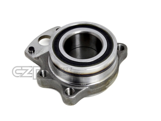

CZP says the suspicious bottom one is for an 02/89 to 03/90 NA.
Is that the case Pete? So what happens to the Handbrake without that tab with the holes in?
