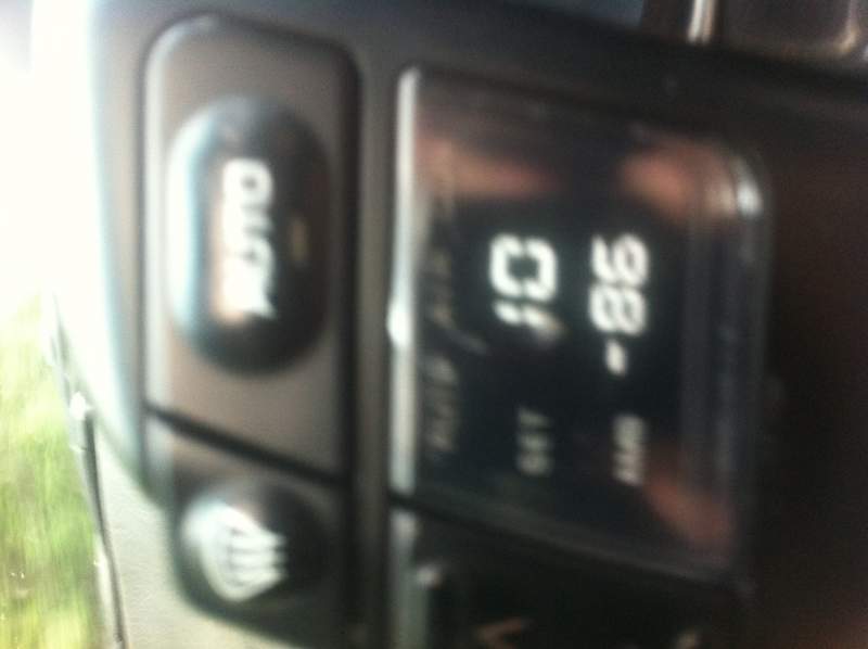

I changed the control unit but still the same only hot air. Here is a pic of what shows the -86 is always there so any knowledgeable people know what this means?
I've got a spare ECU but wanted to wait see if the pic means anything before I take the plunge.

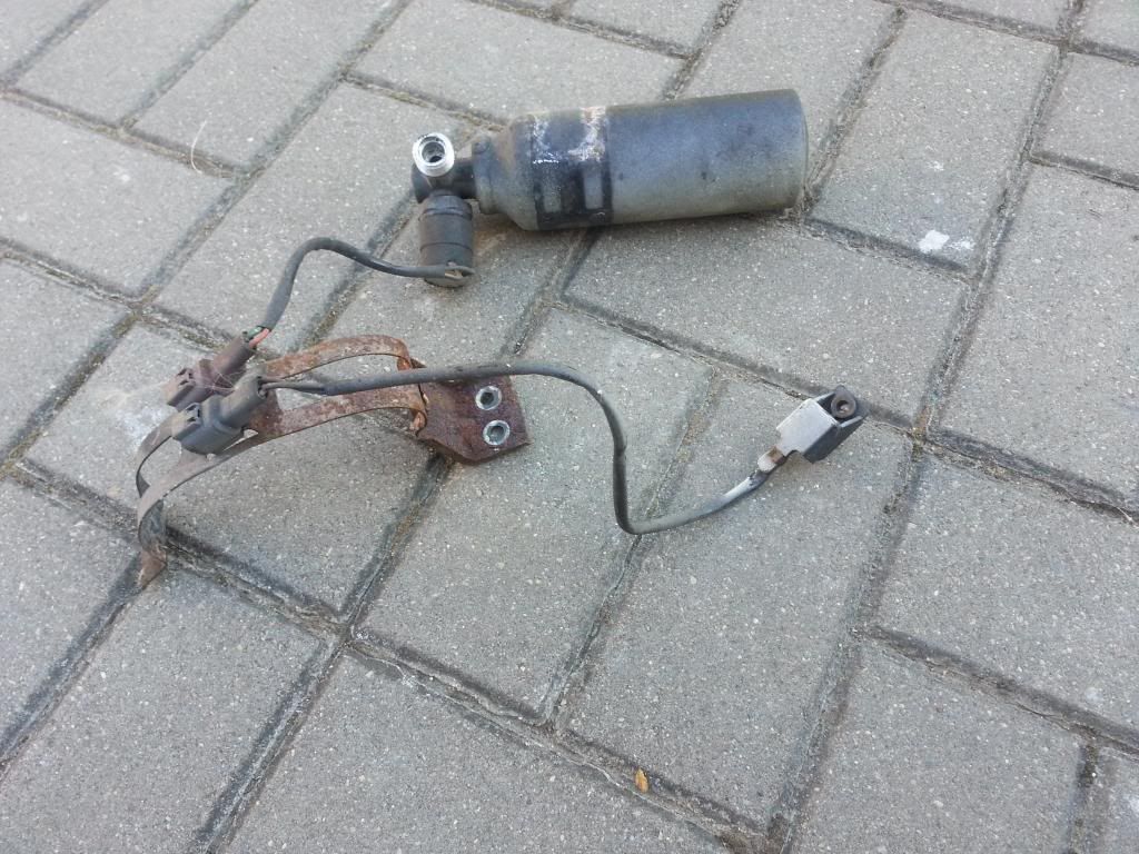

Here's a pic of amb temp sensor. But my guess is one of the temp sensors in air ducts is gone. I had the same problem
