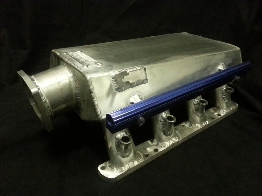

what type of TIG do you have buddy and what size filler rods are you using
More than likely an inverter tig, and by the looks of it he needs to use smaller rods or not push through the puddle as much.
Still not bad welding. I have paid for worse !
yea ime thinking smaller rods myself with a tad more speed....its very hard to master when welding different thickness material. Ime on the look out atm for a ac/dc inverter myself and try steer away from MIG slightly plus the ability to get into a bit of titainium.
Don't forget guys this is aluminium, the bead is far thicker than mild or stainless steel. I actually prefer Ali it's easier to get into a Rhythm, too much heat ends you in a mess quickly though.
I have an Everlast DX200 Inverter Tig. I was using 3/32" filler w/ 3/32" (2.4mm) 2% Lanthanated Tungsten.
It really was tricky trying to weld the .080" sheet to the runner plate which was 1/4". I had my frequency set pretty low so it does make for a larger bead. I probably should've bumped it up to 80-90 to narrow the puddle a bit. Welding the .080" runners to the 1/2" plate was a bear! I'm trying to redesign it a bit so I don't have to put as much heat into the flanges as I needed. Maybe a raised lip where the runner meets the flange.
I bet bud...great job:thumbup1:
Nice work! How many hours do you reckon you put into this of actual construction, not including designing it?
