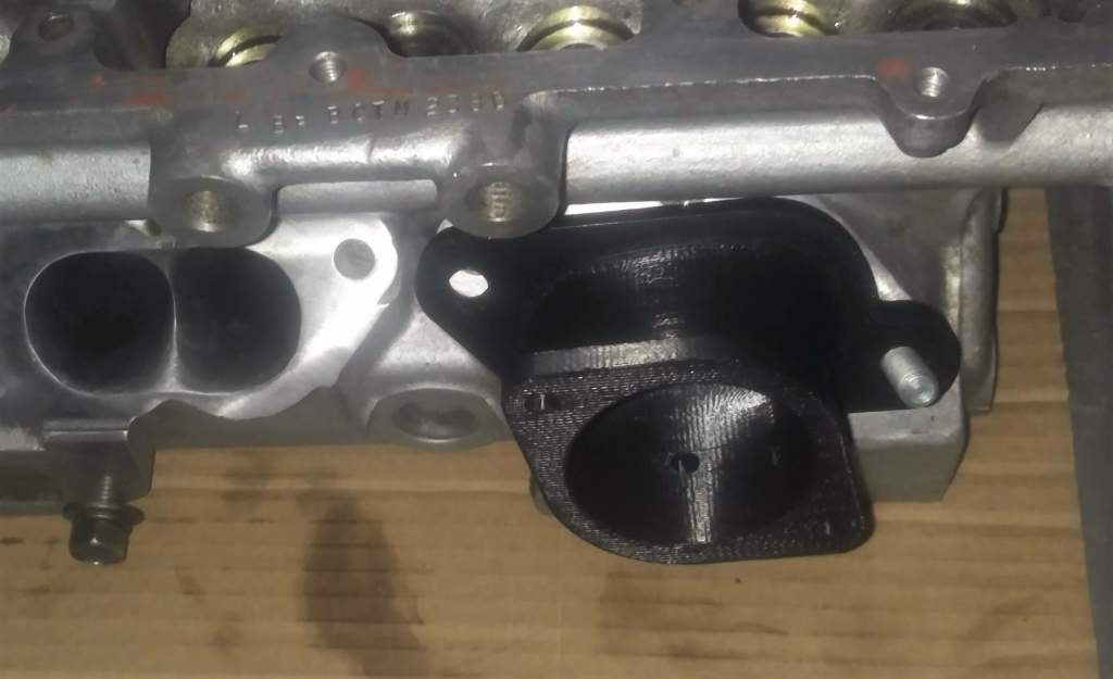

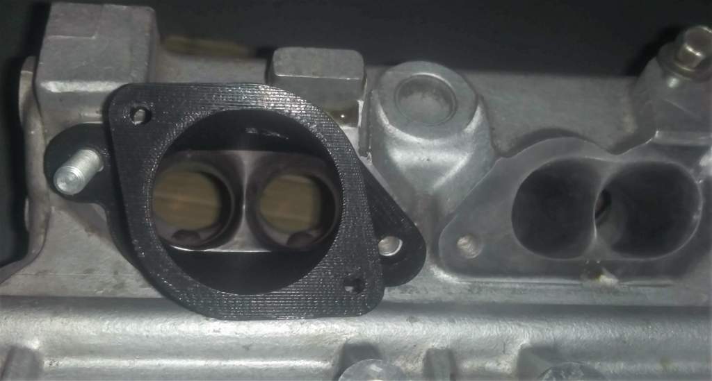

Apologies for the crap picture quality, but these shows a 3D printed prototype for a single piece of my custom lower intake manifold. Its a 45mm to Oval Transition, to which I have modified the inlet ports to enlarged taper and reduced the separating bridge to siamese the ports. Entry is at 20degrees for a direct path to the Inlet Valve. For Hood clearance Im introducing a bend pre-Throttle, and the part is completely straight Post-throttle.
(The ports are for Vacuum feeds)
Mine are being CNC Machined, but If you are considering 3D Printed parts you will need to take into account the inherit porosity of these parts. There are various ways to seal them as a post operation. Using the 3D printed parts for lost plastic cast may be a better method.
I have a 8500-9000rpm Peak RPM target, and will be running with a ~350mm inlet length (Valve to Bellmouth opening).
