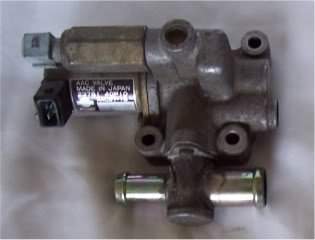

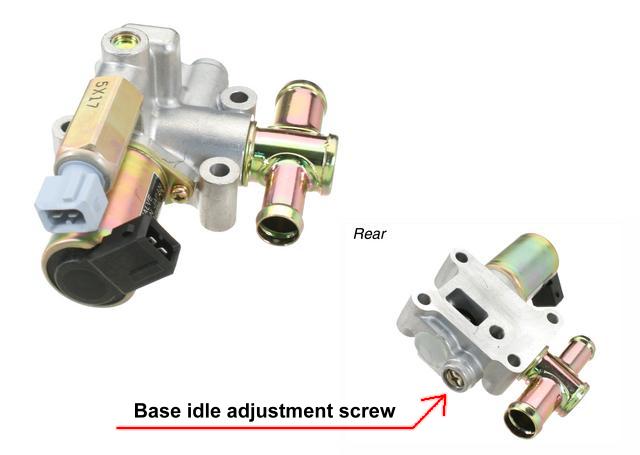

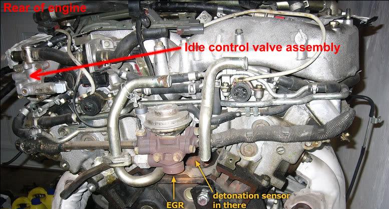

STOP!!!
The issue you have is a simple one that has the potential to develop into more if you randomly or someone else randomly messes about with out knowing what your looking for.
So the fault is a simple base idle tick over issue and a probable fault with the connection on the auxillary valve.
The base idle is the mechanical setting that ensures that with no added tick over speed from the electronic idle stability solenoid that the engine cannot tickover less than 750 to 800 rpm depending on the setting which is done by adjusting the screw on the side of the valve ( back of the engine by the battery location)
Locate the unit and identify the yellow connector on top of it, un-clip it and spray WD40 or similar into both the connector plug contacts and the unit contacts itself.

STOP!!!
Leave the plug undone and locate the adjustment screw ( sometime battery removal can aid this) spray WD40 or similar into the screw area and turn the screw in and out to free it up, now turn anti clock wise until the screw is level with the unit body.
Reconnect the yellow plug and start the engine, hope fully with an improved connection on the unit the tick over will be stable now, and it also may be a little too fast, so when the engine is up to temp, remove the yellow plug again and slowly turn the adjusting screw back in ( clockwise until the tick over is set at around 800rpm, reconnect the yellow connector, do not worry if the revs rise they will stabilise after a moment.
