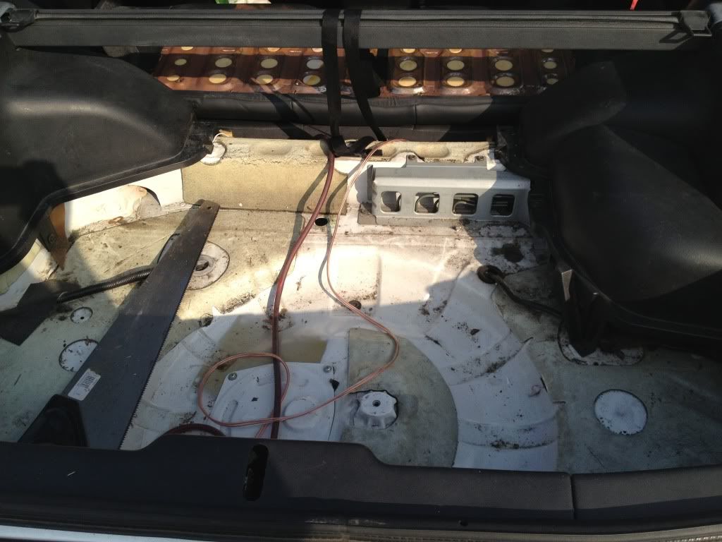

Gutted the boot....

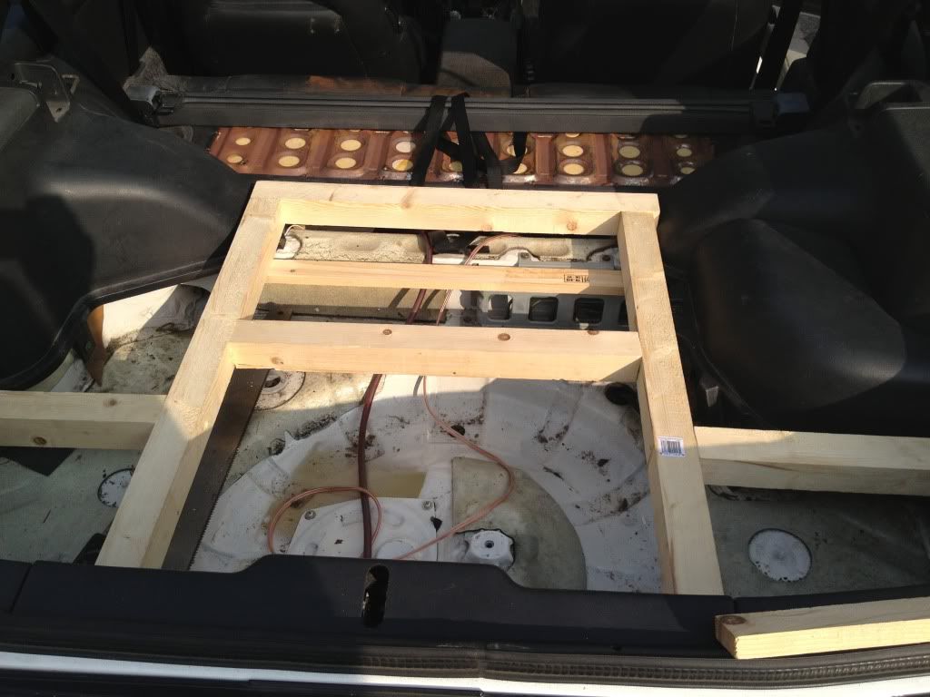

Built a frame out of 2x2, raised the floor up enough for the amp and 12" sub

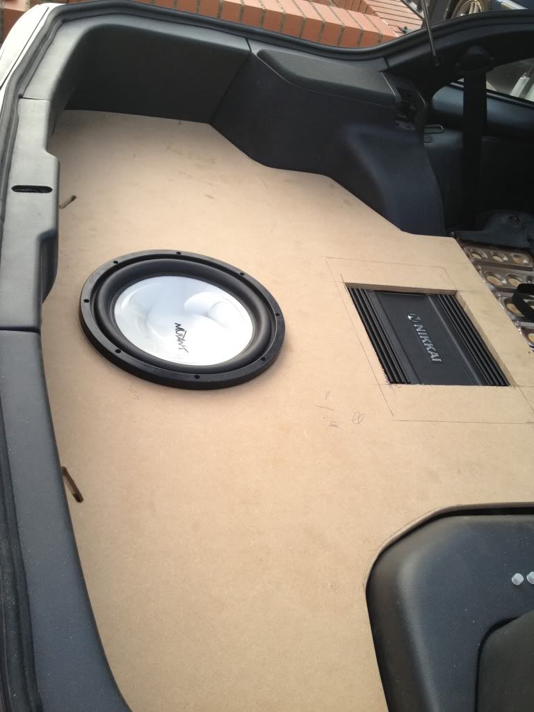

Cut and fit the 12mm MDF, cut and fitted the amp and sub

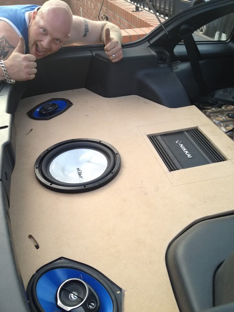

Fitted kenwood 6x9's, also cut slots so still have the use of my targa straps (please excuse the retard !!)

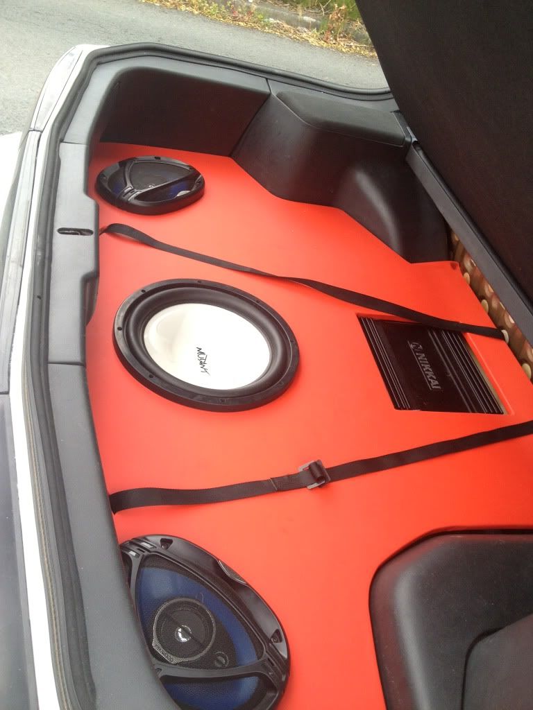

Covered in red vinyl and fitted the targa straps

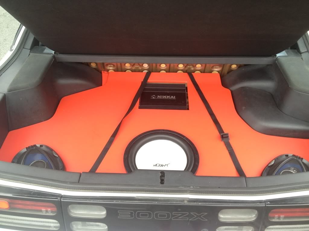

I really like it and sounds quite good too, just got to sort a cover for the sub (got something in mind) and re-cover the back of the rear seat using the boot carpet.
