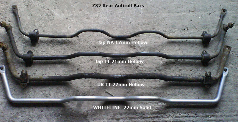

Hi all can any one tell me the thickness of my front and rear anti roll bars please need to order some bushes and theres lots of diffrent sizes its a jdm swb slicktop tt im am putting a na subframe on but think im gona use the tt rear bar as i think its thicker thanks taff.
I think the JDM were thicker than the UK ones. I can measure my JDM one tomorrow if know one knows off hand.
It's the other way round mate, UK is solid JDM is hollow. Not sure if they are different diameters though.
Im confused steams says uk bars are solid picture says hollow .
Me too, I could have sworn that the uk bars are solid. But Yowser does know his stuff, so more likely that I'm wrong..lol
I couldnt say for sure right now...it was a good 5 or 6 years ago now that I looked into ARB's and took that pic.
However, Solid vs Hollow doesn't make much difference - the greater torsional rigidity is a product of the larger diameter.

The Torsional Stiffness is relative to the diameter to the 4th power. (2nd moment of Intertia). The outer surface does the bulk of the work. In relative terms, based on a 2.5mm all thickness, a 26mm Diameter hollow would have approx the same stiffness as a 24mm Solid tube - Taking into account the same material use.

Ok my Jspec tt has a 26mm front arb and a 21mm rear arb which are hollow. Just been out there with the vernier.
One of mine is an NA and the other a TT, both rear and both JDM, both 21mm.
What year (or series) is your NA ?. Its possible the narrower 17mm was replaced by Nissan to be the same as the TT version as standard in a later series. I dont recall which year that 17mm one came off, but I would imagine a Series 1.
