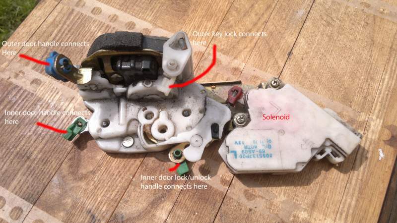

Hi, it sounds like the bar connecting the key barrel and the solenoid to the lock mechanism has come away. If you can hear the solenoid going then it must be the mechanism itself....
You will need to remove door panel to check if bar from solenoid is still attached. does it sound like the passenger side tries to lock and then unlocks again?
I will grab my spare mechanism and have a look later....
Found it and done a quick diagram....:biggrin:
It may just be a case of metal bar come out of one of the plastic clips... or clip broken?
Hope this helps....
Russ
Stripped the door down today, still to take the outside handle off as there appears to be two small covers over the bolt/screw holes, and they are very stiff, trying to get them out without causing damage.
What I can see inside the car is that there is a metal bar that has snapped, trying to figure out where it goes, will post a pic soon.

Sorted, although there was a little collateral damage in that my iPhone got a bit wrecked after I stood on it, had a few nice pics of the repair job as well lol.
Managed to get the two bits of broken bar tied together by bending them then using tying wire, rock solid now and good as new.
