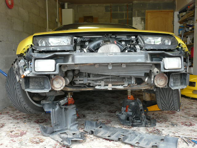

Just fitted my uprated Z1 side mount inter coolers and the question is this: do you guys recommend keeping the original air flow ducts attached or bin them:blink:
I have a 99 spec front end so have pretty large inter cooling apertures!
I have just fitted them and re-fitted these ducts but sat here thinking is hat the correct thing to have done!
Must add they fit like a glove...........well impressed:biggrin:
Thats what I thought but wanted to check before I refit bumper etc
Any hows been busy:thumbup1:
Very nice Dave! When I upgraded mine I improved the airflow OUT of the coolers dramatically, people seem to forget about air having to travel through and out the back,, I relocated my washer and overflow bottles, removed all the unwanted crap round there and louvred the arch liner.

i would modify your ducts mate, otherwise your wasting part of those nice SMIC's.
I would cut the top part off and use some thin metal and rivets to extend it, easy to do even if you have no experience with sheet metal.

Would it matter its only 1 line at the very top!
not really no to be fair it dosnet need all of it to get forced air to be efficient :)

sorry i was on my phone at the time and it looked like alot more was blocked at the top :)
