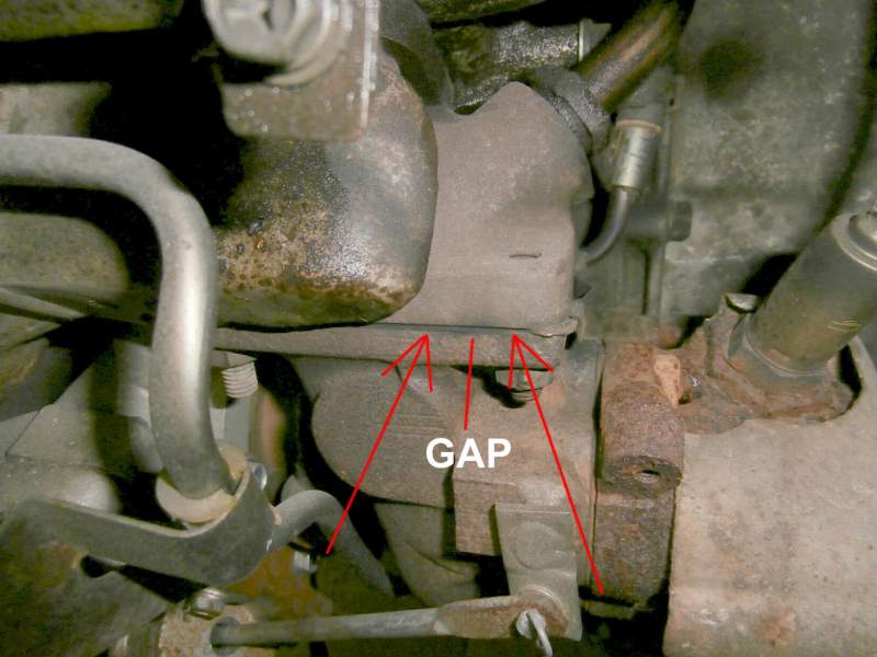

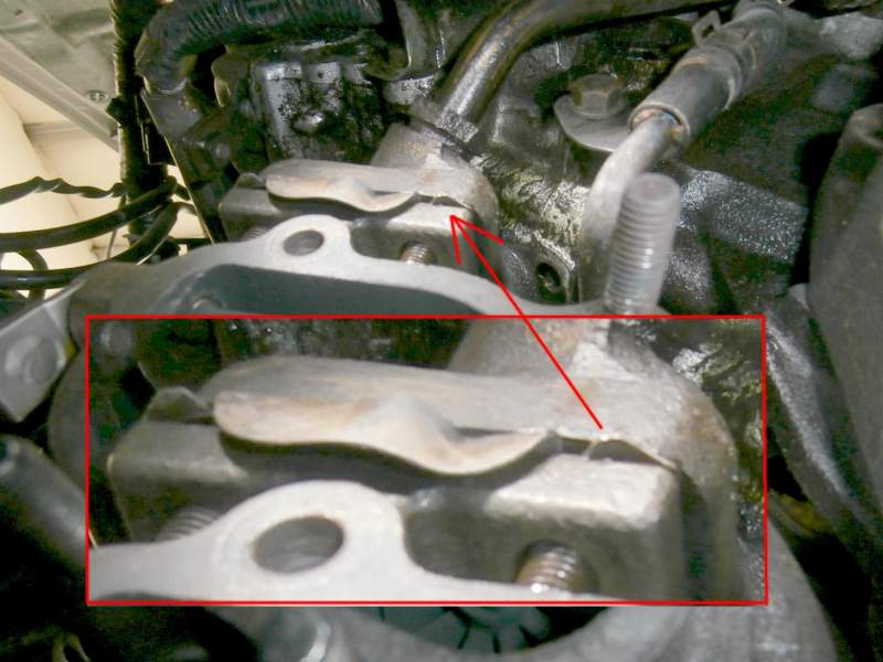

So a zed in the workshop this week was in for cambelt and other work including sorting the leaking exhaust sound.
The zed had been treated to a couple if turbo`s prior to arriving at us, the owner had bravely removed the engine removed and refitted the turbo`s after refitted the engine did not fancy tackling the cambelt.
So after the cambelt was done the exhaust sound led us to the near side turbo and a little look down there with the battery removed revealed a little mistake when the turbo was refittted.
Was a little surprised to see that the tab bracket that should be under the nuts was actually between the flange of the exhaust manifold and the turbo body, little chance a seal could be made.

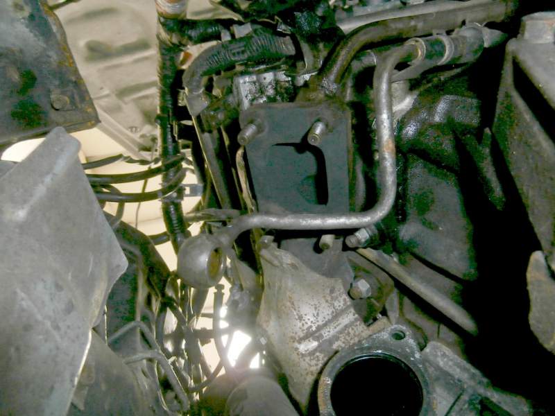

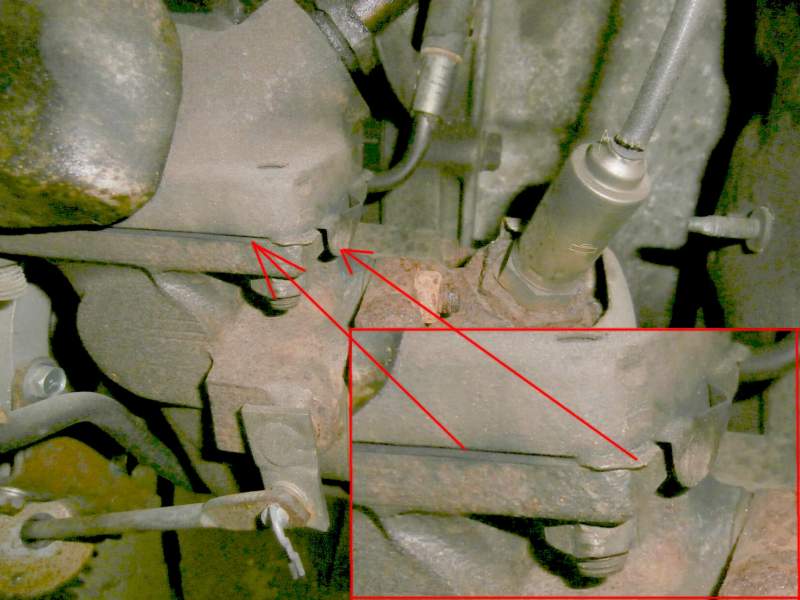

Unfortunately no alternative but the turbo had to be removed, with the down pipe and turbo elbow removed the issue can be seen more clearly, and with the turbo whipped off the sooty manifold leak can be seen.
The owner was suitable peed when it was found what the problem was, a bugger when you make a mistake yourself, oh and he is ok with me posting it here.
The zed had been treated to a couple if turbo`s prior to arriving at us, the owner had bravely removed the engine removed and refitted the turbo`s and then refitted the engine did not fancy tackling the cambelt.
[ATTACH=CONFIG]71496[/ATTACH]
[ATTACH=CONFIG]71497[/ATTACH]
[ATTACH=CONFIG]71498[/ATTACH]
Was a little surprised to see that the tab bracket that should be under the nuts was actually between the flange of the exhaust manifold and the turbo body, no change a seal could be made.
[ATTACH=CONFIG]71499[/ATTACH]
[ATTACH=CONFIG]71500[/ATTACH]
