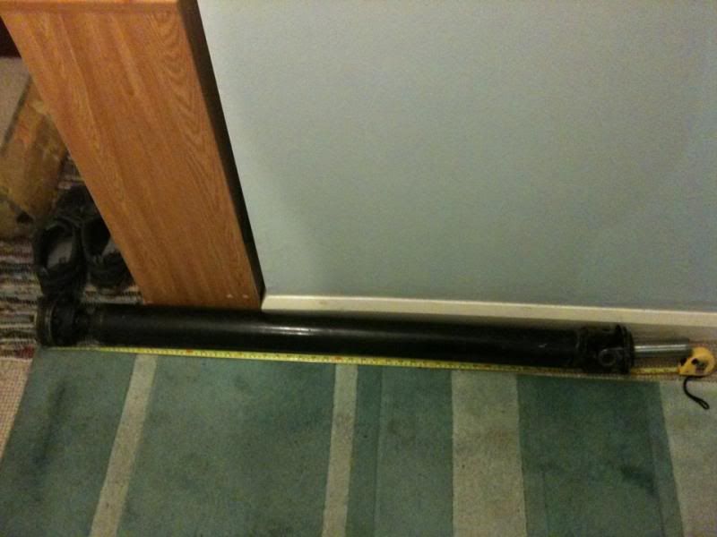

Evening all, So i am playing with the zed now and after sorting out my interior gaiters and stereo situation i have a 1 piece prop to fit courtesy of the previous owner.
How heavy are they as this 1 piece (i am told its a lightweight) i dont have any scales but i would imagine a good 20kgs plus at least.

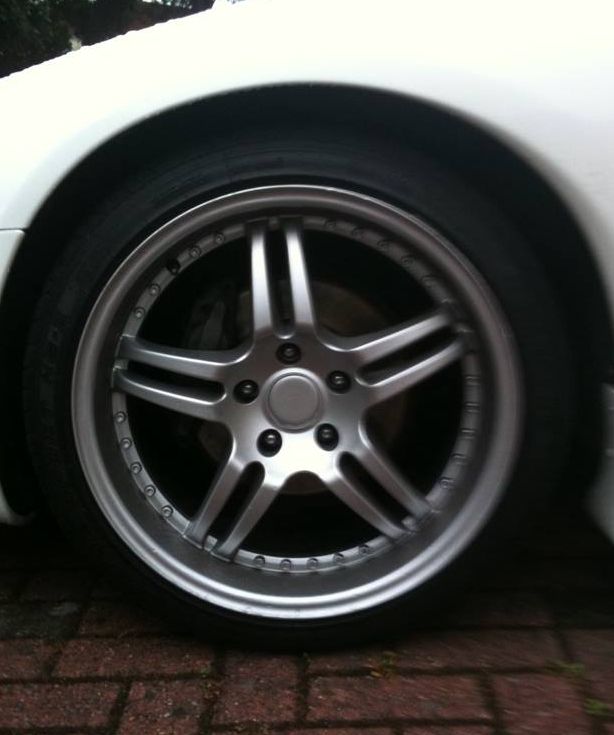

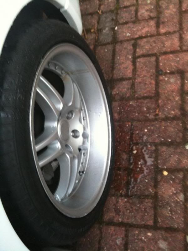

Also i have had a few people asking me the make and model of my wheels. i am yet to receive my hydraulic jack so cant get them off to check. Can anyone Recognize them?

i would say 1 pc propshaft is more like 5kg :) done mine a couple weeks ago ... 30 min job ... 10mm spaner to remove heat sheld 14mm socket to remove one exaust from turbo elbow i guess 17mm socket remove centre bearing and 7mm hex remove 6 screws from diff undo 4 diff screws and i`ll drop dowp ... stick prop in ... jack diff and reasemble everything :) simples :)
Sure them wheels are 'devil' or something
The wheels look very much like Devil wheels, I can check tomorrow as I have a set tucked away somewhere......lol
