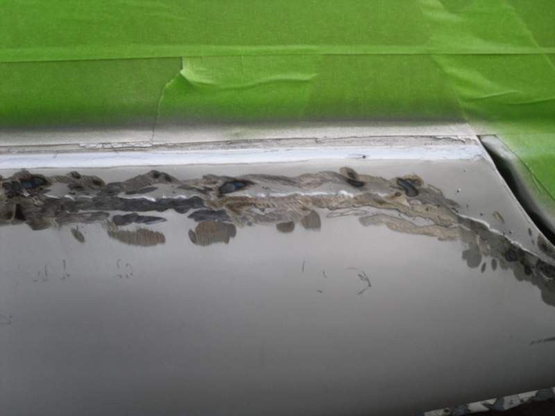

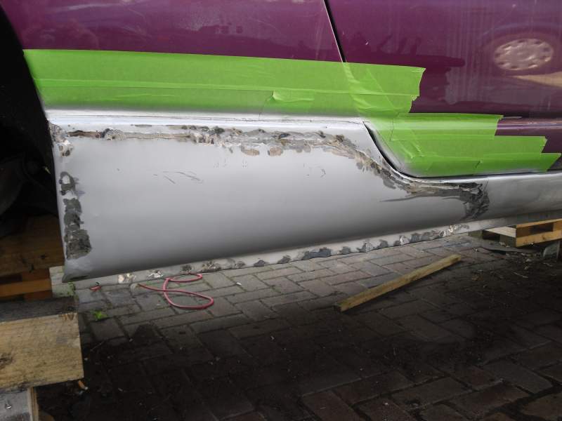

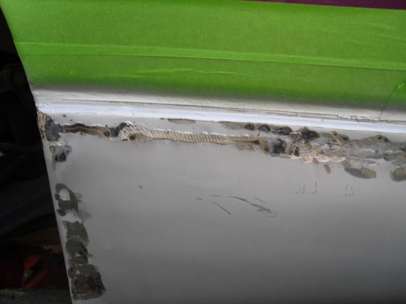

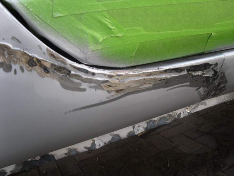

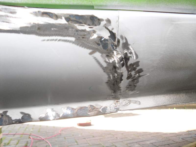

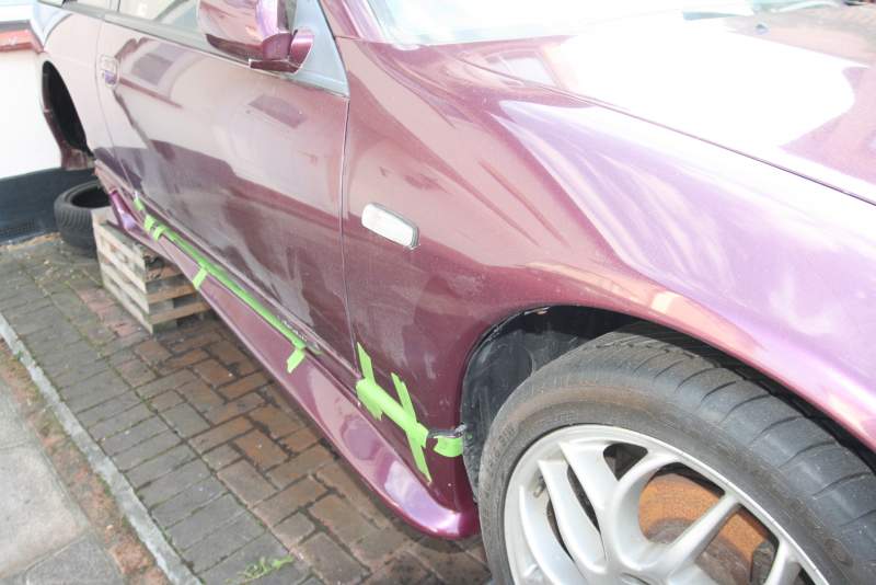

well these are after the grinding session and before I used some body filler.....SDC11010.jpg

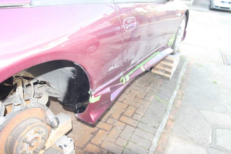

I stupidly got carried away and didn't take pictures after skimming and painting.... But I did get some pics of the skirting bonded back on last night .....
